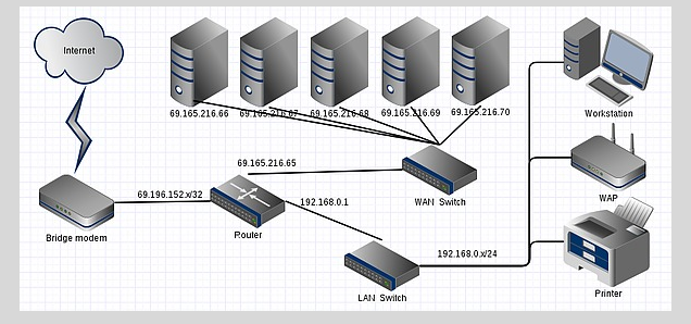

My ISP has assigned me a PPPoE login and with it they give me a static IP (that never changes) when the router connects. But I also asked for additional static IP’s with a /29 bitmask. How do I add those addresses to the router?
The pppoe address looks like 206.243.xxx.yyy and the gatweway is 206.243.www.zzz. I think the gateway changes sometimes when the PPPoE login gets re-initalized.
The static IP’s look like 108.ttt.uuu.216 to 108.ttt.uuu.223. My understanding is that 216 is the network, I need to assign a gateway 217 to the router, and then my 5 useable (for host boxes) IP’s will 218, 219, 220,221 and 222. 223 will be the broadcast address that I can not use.
I can’t find a tutorial or posting on how to set this up on my new RB2011. I am very familiar with OpenWRT and DD-WRT but now that I am past the hobbiest stage I need to the get this and many more Mikrotiks running in commercial environments.
I would appreciated help. Thanks.
How silly of your provider to give you a static address (/32) that’s not already in your static subnet, but that’s beside the point, and it gives you 9 static IPs to work with instead of just 8.
You get your route from the PPPoE session, so that’s taken care of.
Now, just put your subnet on your DMZ interface:
/ip address add address=108.xx.yy.217/29 interface=DMZ
Now, this leaves you with 5 usable addresses from your subnet, which may or may not be enough. You CAN use all 8 addresses though:
/int bridge add name=lo0
add address=192.168.1.1/24 interface=LAN
add address=192.168.2.1/24 interface=DMZ
add address=108.xx.yy.216/32 interface=lo0
add address=108.xx.yy.223/32 interface=lo0
add chain=srcnat action=src-nat src-address=192.168.1.0/24 to-address=206.243.xx.yy
add chain=dstnat action=dst-nat dst-address=108.xx.yy.216 to-address=192.168.2.216
add chain=srcnat action=src-nat src-address=192.168.2.216 to-address=108.xx.yy.216
add chain=dstnat action=dst-nat dst-address=108.xx.yy.223 to-address=192.168.2.223
add chain=srcnat action=src-nat src-address=192.168.2.223 to-address=108.xx.yy.223

Well, it’s not really all that silly from a customer perspective, it just gives you an extra address to use.
As a provider though, it is silly, they’re wasting an IP unnecessarily. Comcast does this as well, a customer with a subnet assignment also gets a static IP outside that subnet. What’s infuriating about Comcast though, is that they keep the subnet captive within the router, which wastes 4 IP addresses (static, network, gateway, and broadcast). Bleh…
As a provider myself, if a customer wanted a static subnet, the static IP would be assigned out of that subnet, and the subnet itself would be routed to that static IP. The basic customer config would give them 5 IP addresses to use in the DMZ (use the GW address to NAT the LAN).
The customer could, however, bind all 8 IP addresses (as /32) to a loopback, then use NAT to take advantage of all 8 IP addresses, so long as they had a router that could handle such a configuration (which MT can).
On a managed customer network that needed 2 addresses, I’d give 'em a MT with a /31 as quick as you please! 3-4 addresses would get a /30, etc…
