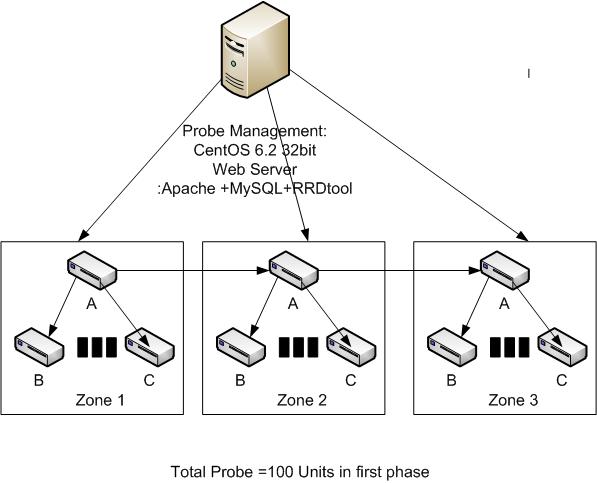

We are developing A Probe Management system using MikrotiK router board(RB751u) firmware 5.xx. It consists of CentOS 6.2 +Apache+MySQL and RRDtools. We focus on measurement functions (Bandwidth test, traffic generator test in tool menu). We use PHP api in our testing according your recommendations API_PHP_Pear2 / Net_RouterOS. Due to so many probes (100 Units) in our first step, we need to divide zone testing as shown in figure diagram in order to preventing broadcast storm when traffic come back to a server. In each zone we establish a center probe (A probe) for originate traffic to the other probes. A server will have schedule test every traffic zone for whole day periodically assuming 5- 15 min per probe. The bandwidth measurement and traffic generator will keep into database and will display in line graph or other.
Background: When the time is at the schedule setting, center probe (A) in zone 1 will execute bandwidth test api to B and C in asynchronous style according duration setting. At the same time, Zone 2 and Zone 3 will do the same way according to schedule setting: We may consider Contrab scheduler in CentOS.
