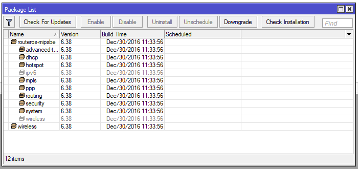

I have a hundred plus remote client Mikrotiks with double wireless packages.
All of this started when Mikrotik came out with a separate nv2 wireless package.
It has been hit and miss (99 percent miss) when upgrading these clients.
If they are in-house, I just factory-default reset them.
However, these are remote clients scattered all over the place. And by experience, I know there is a 99 percent chance that upgrading any of these will result in a brick that even net-install can not fix.
So, how can I remotely fix/upgrade without visiting hundreds of client sites? help help help help

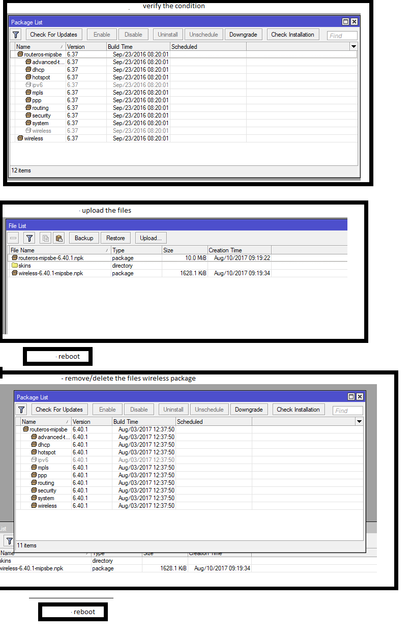

I have a working MOP.
For the condition I have stated in the prior posts on this topic, I have a fix. This procedure worked on a dozen remote wireless client Mikrotiks.
1st - verify the condition:
In winbox - go to System–>–Packages
You will see all the packages on the remote Mikrotik.
Verify the 1st wireless package (the one that is included in the base system is disabled (greyed-out)
Verify the 2nd wireless package (at the bottom) is enabled (not greyed-out )
2nd - up-load the updated ROS into files (do not reboot - yet)
3rd - up-load the optional stand-alone wireless package info files. (same version as the ROS file in step 2 above)
4th - reboot the remote wireless client Mikrotik
5th - when the remote wireless Mikrotik comes back, check System–>–Packages and verify you now only see one wireless package
6th - in Files , delete the wireless-x.xx-npk file
7th - reboot
North Idaho Tom Jones
8th - using “New Terminal” check your /system /routerboard print shows the current-firmware -and- upgrade-firmware both match. If not , then upgrade and reboot.
(I performed this on a dozen or so remote wireless Mikrotik clients, all of them came back on-line and appear to be working properly.
I hope this helps anybody else experiencing this …
EDIT: This procedure appears to also work on Access-Points and both sides of wireless WDS links
