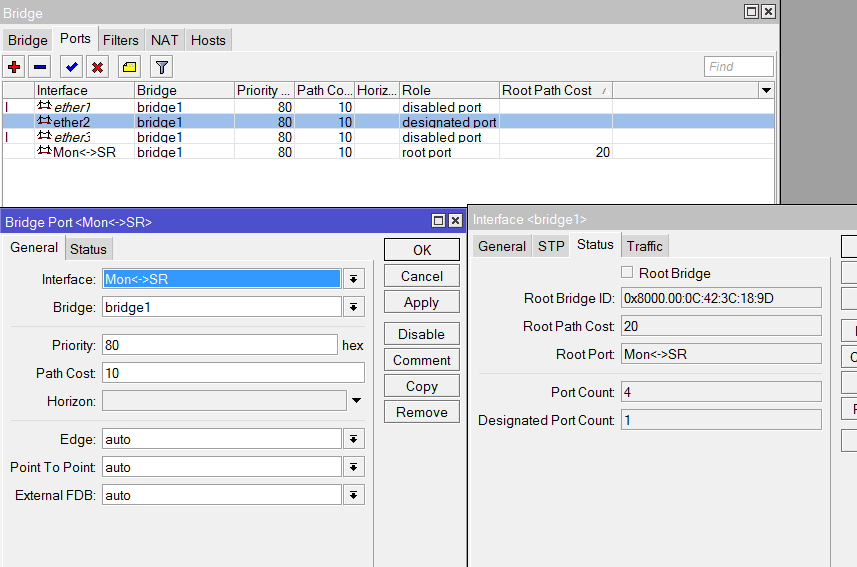

On my board is created Bridge1 and RSTP enabled (433Ah+R52Hn ether1,2,3+wlan1 in bridge1)
as I can see bridge1 is always selecting wlan1 role as root port - its like whatever I do

This is my case
Now how can I change my interface role as root port?

Set an admin-mac on the bridge.
If you don’t set an admin-mac then the bridge uses the lowest mac address of its members, which means that the bridge reconfigures every time a wireless client connects/disconnects.
