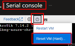

Is there a third option not in your screenshot? I’ve had to try them all, one at a time, on various cloud platforms, to get it to work..
Otherwise, extend the timeout way past 5 minutes and open a ticket for the provider to do it for you..
You need a power-off/reset without shutdown.. If it was a normal PC, would be holding the power button for 4 seconds to power off rather than pressing once to let it shutdown normally..

Azure VM container enabling:
  1. VM control panel open “serial console”
  2. press power button
  3. select “reset VM (hard)”
