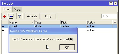

I can now see the picture and that states that the “store” is in use and then stopping Dude first is needed as Shadeofspirit suggests.

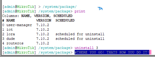

I have worked with MikroTik Products for the last 13 years. I just signed up to respond to this issue!
It is a very simple task to remove “Dude” from the mikrotik.
Simply go to a terminal, and then
type “/system/package”
then… type “print”
you will see a list pop up with the word you are looking for. If you notice there is a
number to the left of the word “Dude”.
Now… Type “Remove 3” for example. change 3 to whatever that number is on that line!
Then issue a reboot to the mikrotik and there you go. Problem solved without a reinstall.
TYVM!
Sincerely,
Thalia Sophia Montreux
Senior Network Operations
PentaSTAR Studios
This is easy here I made an example how to do that! Dont forget to reboot your router after you set it for uninstall! and it will be gone next bootup!
Have a wonderful day!
-Thalia
