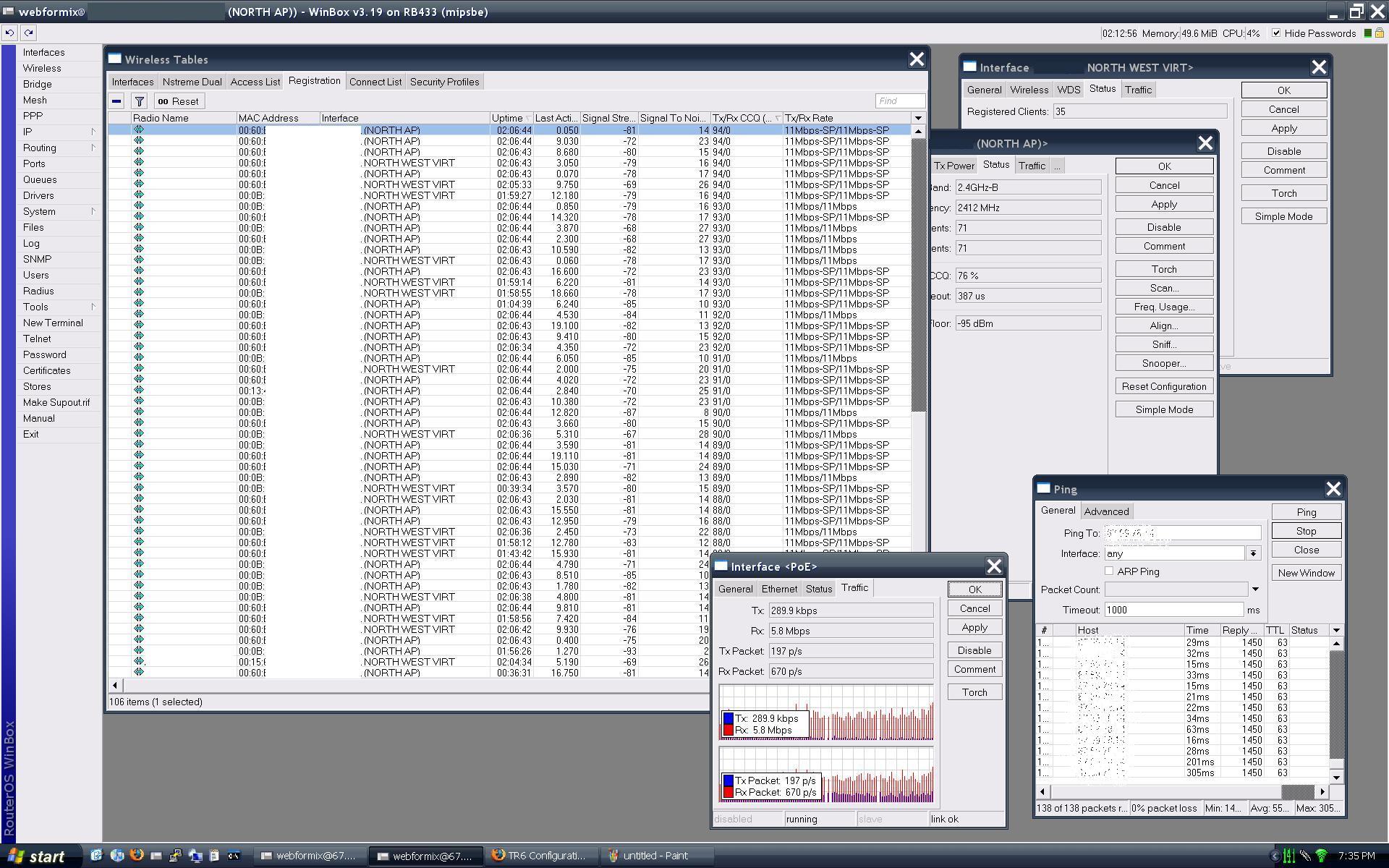

I’ve posted a screen shot of winbox with a single 802.11B AP, with 106 users connected, pushing just over 6mbps traffic. Some keys to getting these kinds of results:
-Relatively low noise floor
-Almost all clients are connecting at 11mbps RX/TX with short preamble
-We use RTS/frag settings of 512/1024 (respectively) on the client CPE’s
-XR2 card connected to a 120deg h-pol sector
-Clients that have integrated router, QoS and bandwidth controls (like Tranzeo CPQ, or Ubiquiti PS2)
-We also use WPA/AES encryption on all connections
-Clients TX power turned down as to not over power the AP and create self interference
-Ping times can spike on occasion, but as you’ll notice in the screen shot, they average @ 55ms for a gigantic 1450 byte ICMP packet
Looking around at the rest of the winbox session should give you some other clues.
