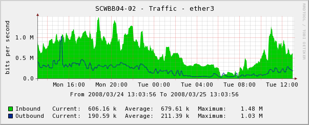

35 clients, tx-rate: 1Mbit ~ 11Mbit, client’s signal: -50 ~ -85dBm, traffic: ~700Kbit per card, total bridge: 1.5Mbit
