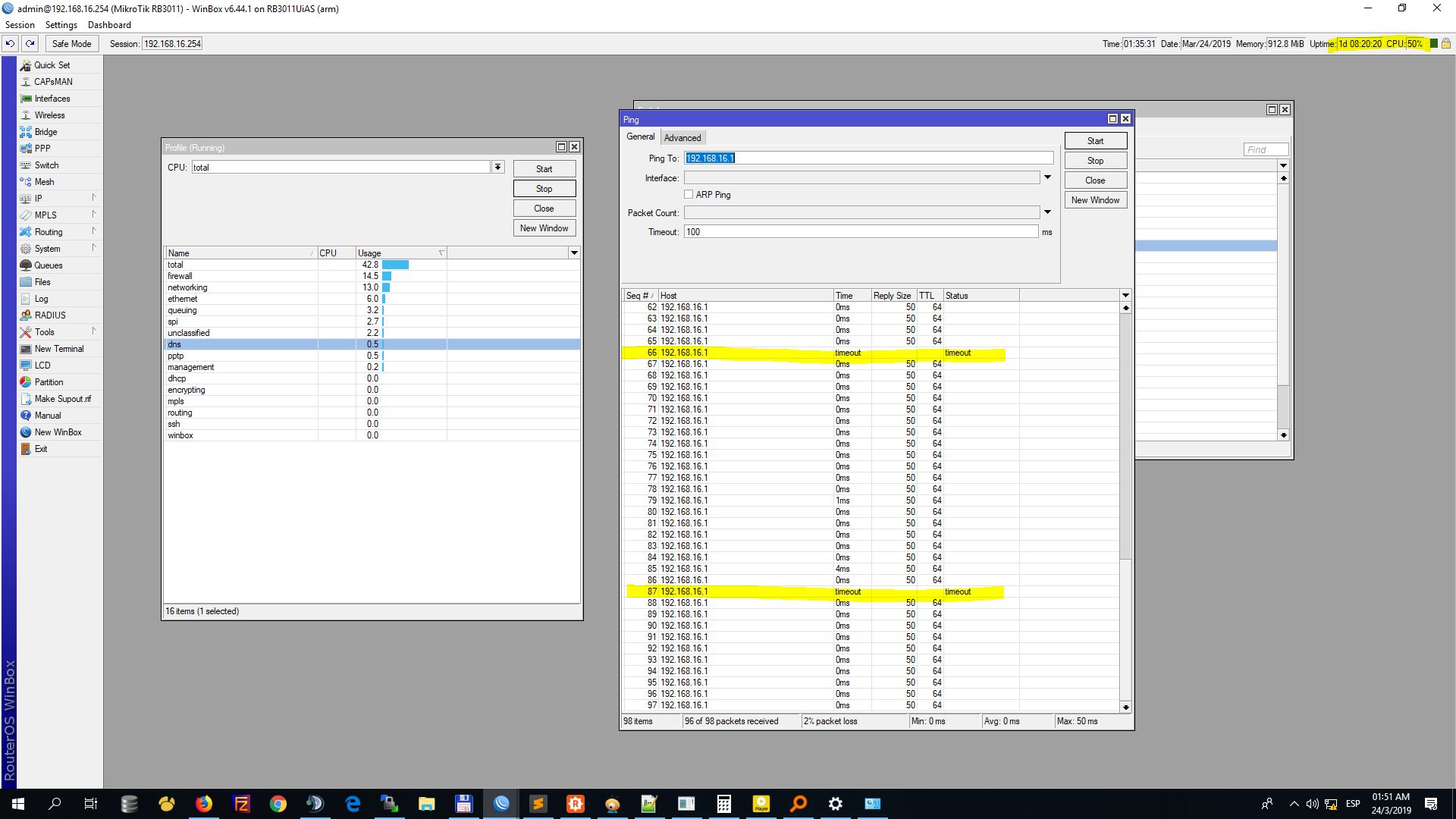

This my config, even when the CPU is at 40% the routerboard mising ping to any server connected to LAN

This is my Interface photo, and my config on the x86, there is no problem of CPU Load is something that is failling maybe is the config
