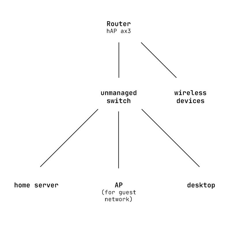

I need advice about how to separate AP for guest network behind unmanaged switch? And what would you recommend to use as AP to have ability to control traffic on AP but isolate clients from each other and isolate from home network as well. Thanks.
What are you using as the AP for guest network? You could connect the AP direct to your router and then connect the unmanaged switch with the server and desktop to the second port on the AP.
How are you doing your guest network? It would be normal to use a vlan, but you could just use a separate IP subnet with no route to your main subnet.
What is your unmanaged switch capable of? If you are using vlans, some unmanaged switches will respect vlans, without actually participating.
Short answer no, either get a managed switch or put the AP directly on a port, or use a virtual WLAN on the hapax3 for the guest wifi.
It is quite doable. I have suggested 3 ways, of which the first is completely compliant with your thinking, if OP reconfigures slightly and uses the AP as the managed switch.
How to assume the AP is a smart AP??
Unfortunately I cannot put guest AP directly in router, there is only one cable between switch and router. Router, switch and guest AP are on different rooms around house.
Switch is TP-Link TL-SG1005P.
I did not decided yet what to use as AP. I need to cover one large room (about 40m2) where maximum 10 smartphones connect regularly. It doesn’t need to be anything fast. I just want to isolate guest clients and separate them from home network. Listing bounded connections to guest AP would be nice but not necessary.
@anav Room, where I need guest AP is outside of hAP ax3 wifi range.
I’d like suggestions if buying specific AP could solve my problem or if managed switch is necessary as well?
Then the switch should be unmanaged but passthrough;

You can use any Mikrotik AP you like, do you need both 2.4 and 5 GHz coverage for guests?
Maybe an older used one might be enough.

A single 40 sqm room, let's say 5x8 or 6x7 would be better covered by a ceiling AP in the middle, i.e. a cAP if Mikrotik OR by a wAP Ax in a corner.
As others have said, you can try to use the unmanaged switch as a passthrough. It should not interfere with the 802.1q headers. However whether it will support the 1522 bytes of frame size is another question (see https://www.tp-link.com/us/support/faq/697/ for a test). You would do yourself a huge favor by replacing that unmanaged switch with a manageable one.
If you can't replace the unmanageable switch and can't use the passthrough method and if the AP supports it, a possibility is to create a L2 tunnel between the AP and the hAP ax3, and bridge your guest network over that L2 tunnel.
Lastly, if you use a Mikrotik AP, CAPsMAN in manager forwarding mode would be possible (CAPsMAN Manager Forwarding Mode)

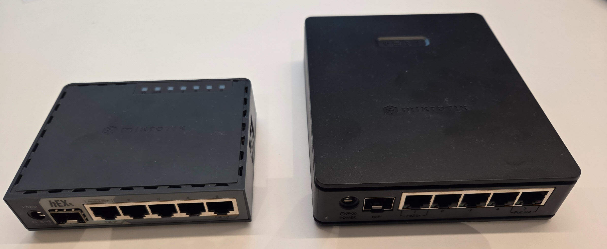

If you want, photo of Hex S 2025 and hAP AX S next to each other:
