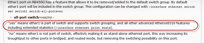

To clarify:
RB750 ports 2-5 can be switched together;
RB750G ports 1-5 can be switched together;
RB450G by default ports 1-5 can be switched. Supports “switch-all-ports=yes/no” that lets you remove switching ability from ether1, but increases ether1 troughtput to other ports in bridged, and routed mode.
