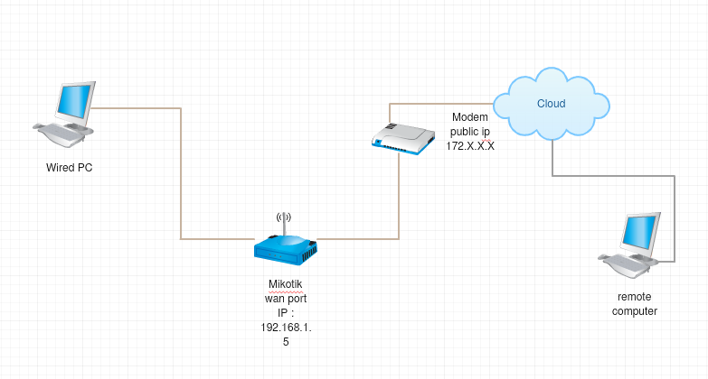

hello all
if I have a network as below, and if I want to access my Mikrotik from internet how to do this, please

If you have no Firewall rules on Mikrotik device, so you should just create some Forward rules on your Modem.
For example for web you must forward 172.x.x.x whatever port to 192.168.1.5:80.

This is not a setting in MikroTik. It’s at your modem.

You need to know what is your public IP address, based on the diagram you provided it should be 172.X.X.X, but you can check it on www.wimi.com This is your remote IP.
In remote port an IP use this:
IP address: 172.X.X.X
Port start:8291
Port end: 8291
In Local port and IP use this:
IP address 192.168.1.5
Protocol: TCP
Port start: 8291
Port end: 8291
It should work., you should be able to connect to your mikrotik router from the internet using WinBox. Just use the 172.X.X.X as the address and your configured credentials.
But keep in mind that by these settings you are allowing access to your router to anyone, so please secure your router properly!
