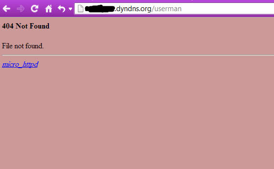

usmanayub07 , 4okran leek 3la el rad bas el mo4kila enny b3mel zy ma bt2ool bygeeb saf7a mktoob feha (404 not found)

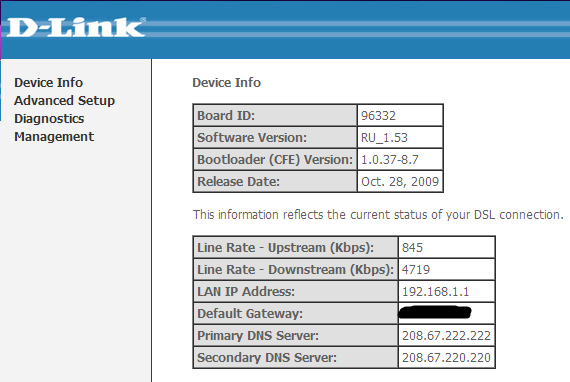

mahnet, thanks for replay, I tried it with dyndns but I field to access it, because it attached with this ip (192.168.1.1) not (192.168.1.2)
Server IP
I adopt that I should open a new port in the Router but how ?? and what is that port (I’m using Dlink Router Adsl+2)
You have two options:
  • don’t use ADSL router as gateway - configure Mikrotik as PPPoE gateway and use the ADSL router only as modem, it will be more stable and more powerful
  • if you really need to use ADSL router as gateway, then you will need to configure port mapping on your ADSL router (map TCP/80 to Mikrotik’s IP) - in this situation, only ADSL router is really connected to Internet, not Mikrotik, that’s why it is not directly accessible
