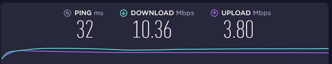

Today UL is stable (but low):

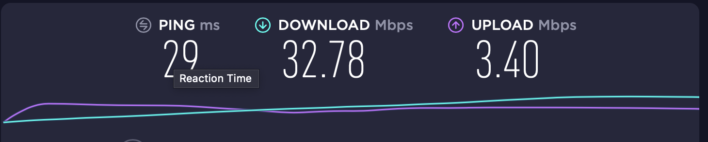

This morning I got this speed:
Then this afternoon I get this speed:
The other day it was even worse with ±4Mb DL and 1-2Mb uplink (while 2 months ago I always had UL over 20Mb!!!).
With such variations its really hard to make good bandwidth control, and shows the limit of LTE routers for home usage…
