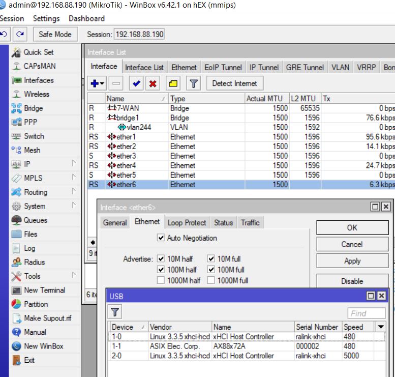

Hello olivier
see this ..
https://www.mikrotik-routeros.com/2013/04/apple-usb-ethernet-adaptor-routeros-success/
tested and still working with mipsbe HEX (don’t have a rbm33g to test) -
yes 6x ethernet, the last is the usb dongle.
Engitech
Would be really nice if Mikrotik published list of VID/PIDs of supported hardware in RouterOS. Be it MiniPCI, MiniPCIe or USB devices… all of them. I wonder when some card works in x86 build of Mikrotik (you can test that on an notebook, just install ROS on USB stick) if it will also work on ARM build and board like this nice RBM33G. You can get 1x PCIe to MiniPCIe extender and use pretty much any PC sized card in RBM… but actual driver availability across platforms is a big question.
the most el-cheapo single port FE usb dongles out there on ebay just work fine.
they are kind of limited however on throughput.
