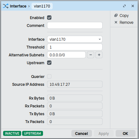

Thanks for your kind reply. For your understanding, we use several VLANs with multicast (e.g. KNX, HDMI and audio streams).
 > /routing/igmp-proxy/export
/routing igmp-proxy
set query-interval=15s quick-leave=yes
/routing igmp-proxy interface
add alternative-subnets=0.0.0.0/0 interface=vlan1170 upstream=yes
but my IGMP porxy does not activat the "Querier" and stays "inactive".
What am I doing wrong?

Thanks for your support, but I am wondering why the proxy stays in INACTIVE state:
/routing igmp-proxy
set quick-leave=yes
add interface=vlan1170
add alternative-subnets=0.0.0.0/0 interface=lo upstream=yes
State:
> /routing/igmp-proxy/interface/print
Flags: I - INACTIVE; U - UPSTREAM
Columns: INTERFACE, THRESHOLD
#    INTERFACE  THRESHOLD
0 I  vlan1170           1
1 IU lo                 1
Make sure /ip/address is added to vlan1170 and lo.

Hi there,
IP adresses are set fine, but still INACTIVE:

Do you have any configuration under /routing/pimsm ? If you have added interfaces to PIM, it will not allow IGMP proxy to start.
Yeah, that was my fault. Thank you, everything is working fine now!
