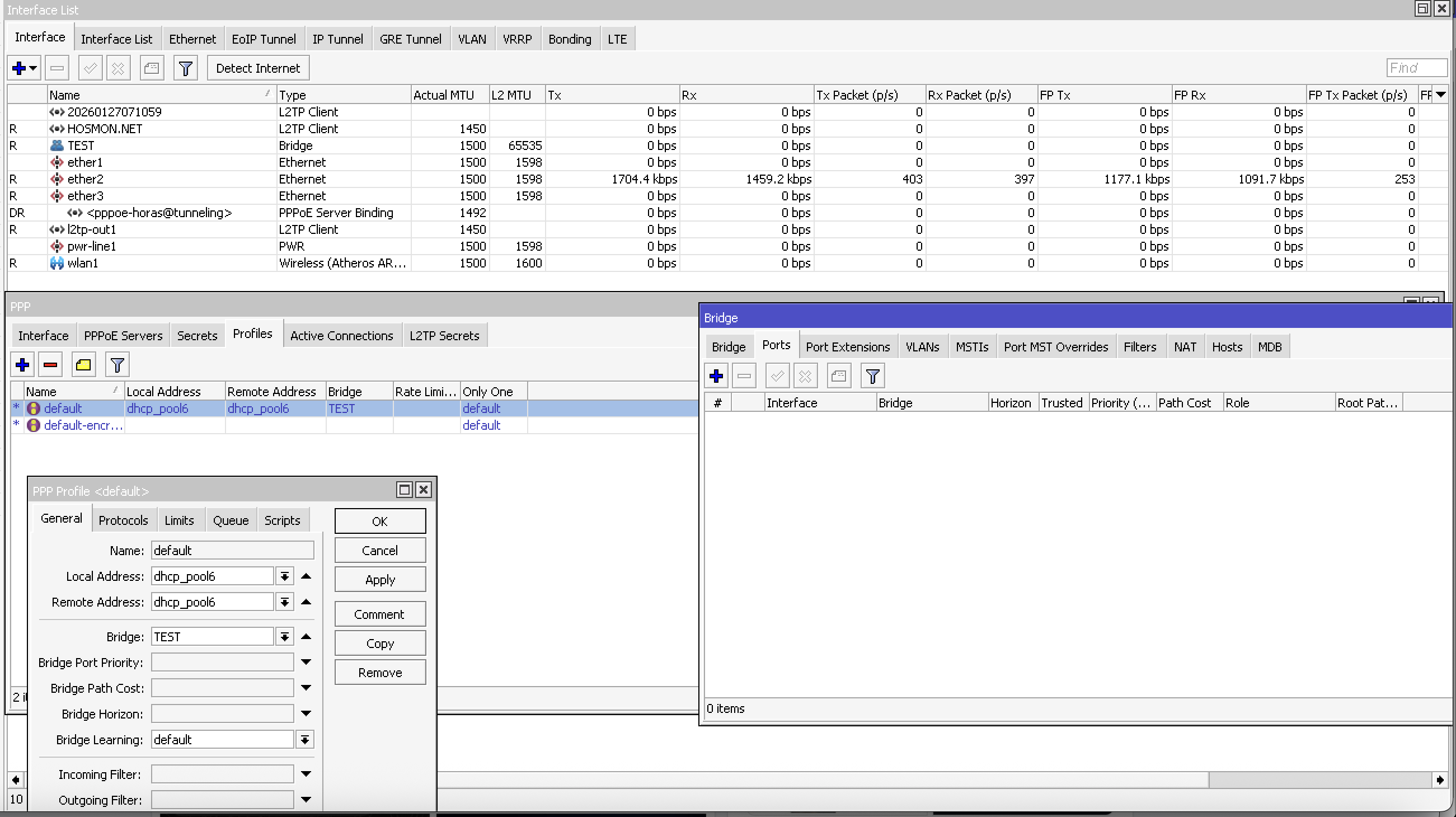

How to add l2tp to bridge
why my interface client ppoe not add to port bridge..?
even though I have directed my PPP profile to enter the bridge interface
pppoe interface is L3 interface and thus can't be joined to L2 network (bridge).
OTOH title of thread reads "how to add l2tp to bridge" ... and that should be possible. So it's unclear what exactly is the problem you're encountering.
