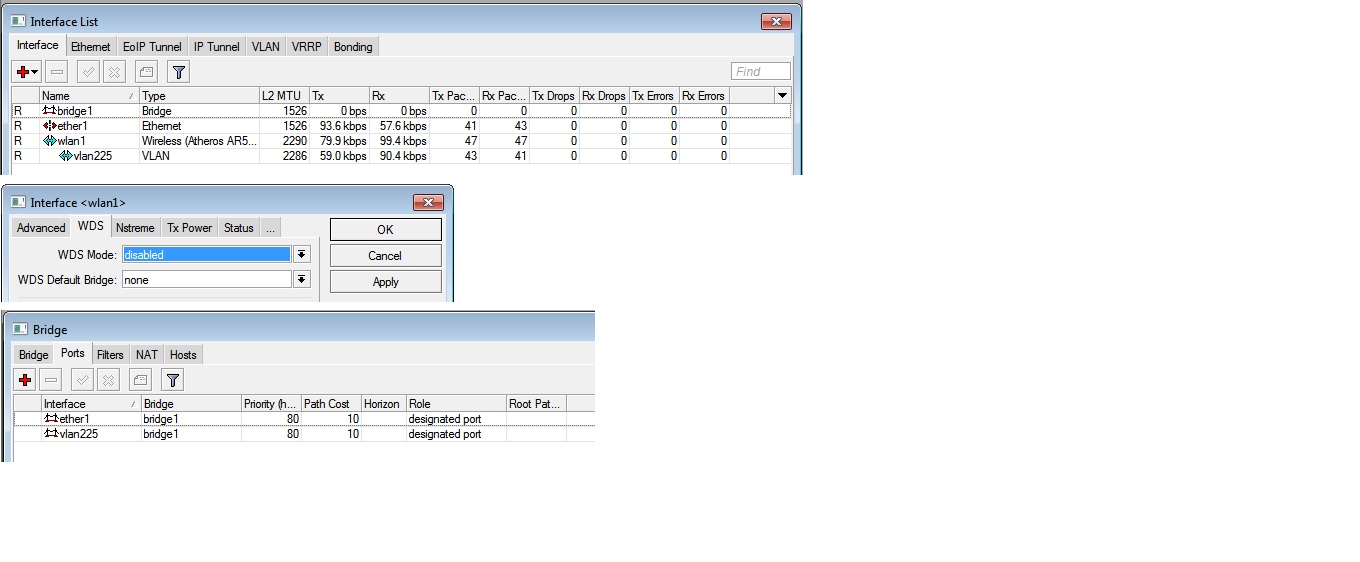

you can add vlan tag on mikrotik wireless interface
Where exactly? I didn’t found anything about VLAN there (http://wiki.mikrotik.com/wiki/Manual:Interface/Wireless) I could create VLAN over wireless interface, but it is not what I need - at least I think.
I thought that maybe I could use switch rules, but the rules are defined for incoming ports (and new-vlan-id is available only on Atheros8316).
snap is attached for ref.
This is not what I need. It just joins existing VLAN-marked wireless packets to ethernet port as bridge. If client (notebook, phone) connects to wireless interface, he will not be handled as VLAN.

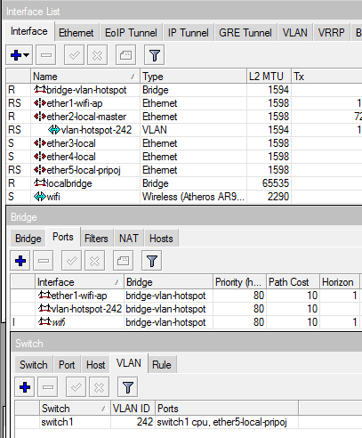

Edit: I’ve realized that it may be useful if I do it on opposite direction - VLAN on ether bridged together with WiFi. I am going to try…
Yep, now it is working exactly how I need :slight_smile:
share your snaps for future config
thanks
Well, here is it…
  • This router is configured as an AP.
  • There is another AP (not mikrotik) connected to ether1.
  • There is a VLAN 242 on ether5 connected to hotspot on the main router.
  • All packets from both APs (integrated WiFi and another AP) should be transported to hotspot only.
