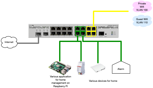

I have a wired network for home automation (green on the schema). I want to keep it isolated as manufacturers are not the best to keep them safe. The raspberry in this network is serving with various applications. It is the only reachable component in this network from other network (including private wifi).
This setup is working fine for web applications or for application connecting using the IP.
Unfortunately, it is not working for discovering protocols like Bonjour… It seems that mDns proxy may be the solution but it is not supported by Mikrotik and some member of this forum are strongly arguing against it.
An alternative may be to add the Raspberry in the vlan of the private wifi.
After many attempts, I failed to do it.
How to add VLAN form the yellow bridge to only a port currently in the green bridge.
