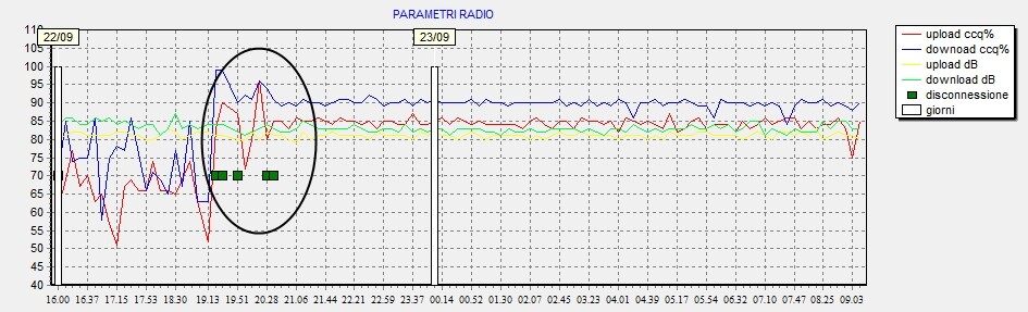

In the graphic you can see the effect of limiting the data rate at cpe-side.
You see: tx and rx db remain costants but the ccq rise, and not more dosconnections:
My question is: limiting the data rate at CPE side, causes collateral effects AP side ?
thanks
lowering the data rates could make your link more stable, but really not in this case, the signal is just too bad. you need to find a better positioning for the antenna
