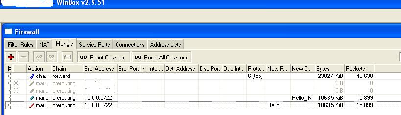

/chain=prerouting src-address=10.0.0.0/22 connection state=new dst-address-list=local Action markconnection new-mark-connection=hello_in passthrough=yes
/chain=prerouting src-address=10.0.0.0/22 connection-mark=hello_in Action mark-packet new-packet-mark=hello

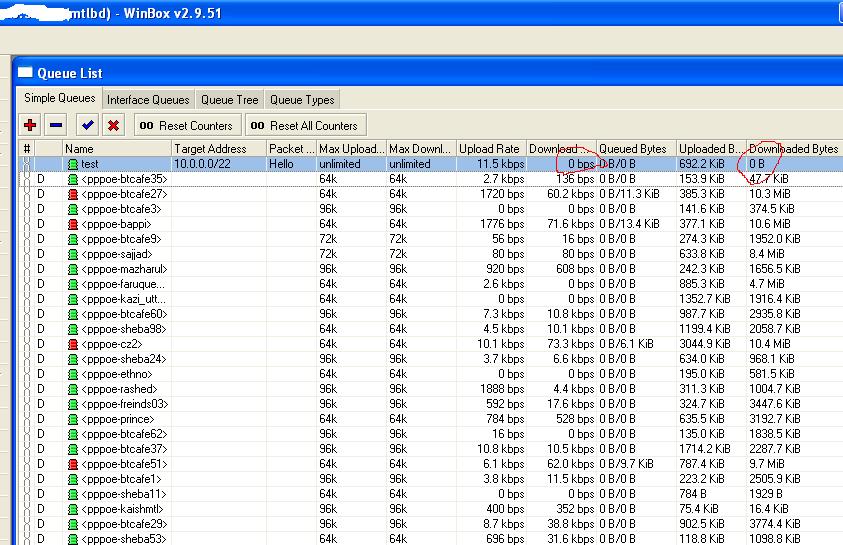

/name=test target-address=10.0.0.0/22 max-limit=unlimited, limit-at=unlimited packet-mark=hello
But i dont get unlimited speed in locally. it’s working as profile wise speed

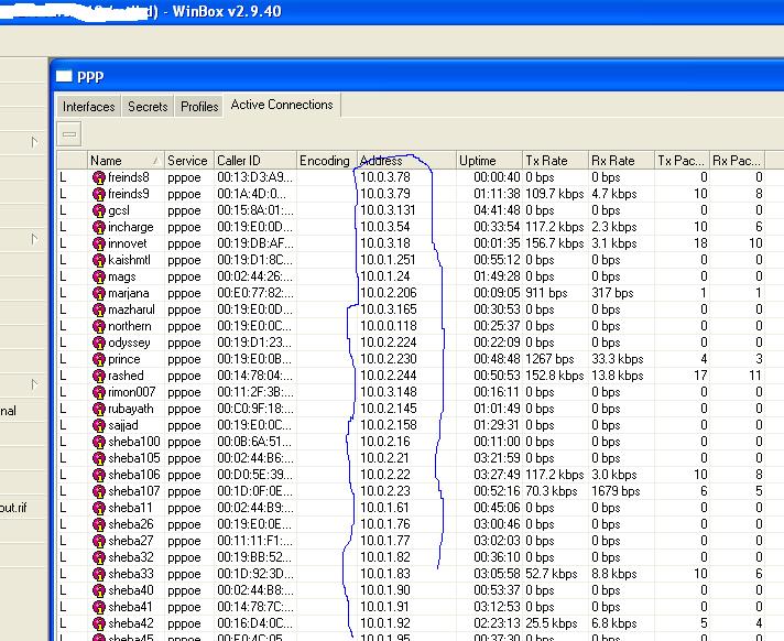

Which IP addresses are assigned to clients ?

Below pic is assigned ip for clients…

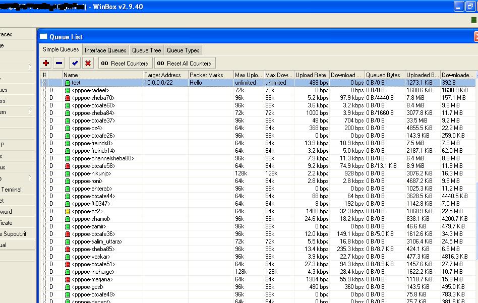

thnxs “omega-00” i dont need that script. plz check my first pic. there i have put a queue named “test” at the top.
it’s not working… any other idea… :frowning:
Upgrade to 2.9.51 version and post screenshot from you mangle rules.
plz check the “test” queue, (red mark) there is no download bytes has sent.
