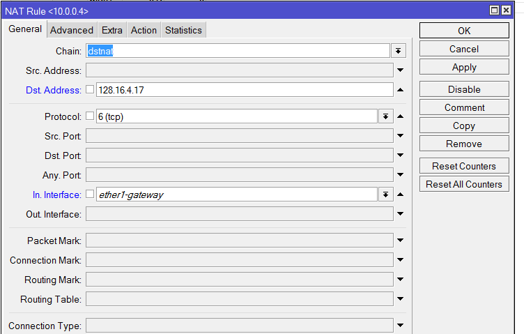

For my Incoming Policy I just set my dst-nat to this:

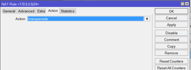

And it already worked. My problem is that although I already created a masquerade for all the local IP’s stated above, when I go to websites like mywanip.com to check the current IP address that I have I keep getting only one Public IP which is the first one the 128.16.4.17.

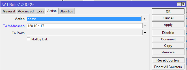

I can’t find a way to make my “masquerade” and “same” in my src-nat to work together.
“Masquerade” will be my source of internet connection and “Same” will make sure that I’m using the allotted public IP. Am I right?

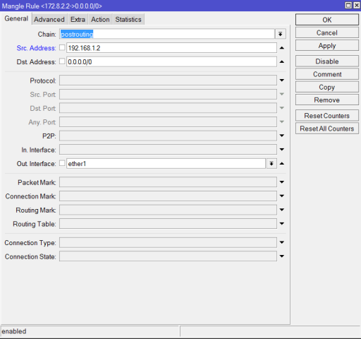

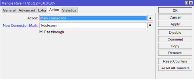

Created a Mangle to define my source and used postrouting.
Action is new-connection
Nat Rule masquerade for my Internet Connection

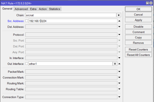

Implemented a src-nat that would forward the local connection to a designated public ip.
