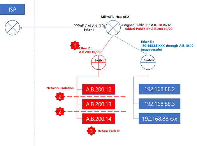

I am setting up network like the image above, but cannot find the right way as yet.
My ISP provides A.B.10.10/32 as the first public static IP and has added the block (A.B.200.10/29) later.
By adding pre-routing rule on firewall, masquerade seems working well, and all PCs under Ethernet port 5 show A.B.10.10 when checking public IP. I think no problem at all in this area, but still not sure that is the right way.
What I would like to do is :
  1. to assign the public IP block to ethernet port 2 individually,
  2. those servers connected through port 2 should not see each other,
  3. each server returns its own IP when requested.
Currently, I have assigned Public IPs like A.B.200.12, A.B.200.13 to each server (manual IP set up on each server) that seems working fine in terms of using Internet.

Yesterday, I read the post carefully once again and successfully set up my network. As yet, no issue at all for
So now I am looking for the solution about 2. those servers connected through port 2 should not see each other.
