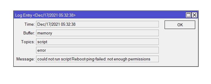

hello and thank you.
i get a message in log that is not enough permissions.
what permissions are need it just to reboot after 5 minutes?
I encountered the same problem and just checked the “Don’t Require Permissions” checkbox on the script setup screen. Now I don’t know if that’s considered safe from a router security standpoint, but it eliminated the problem.
