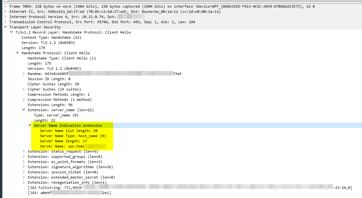

So further searching for “detect sstp” led to another hint:
SSTP can be detected using a regular Mikrotik. It is enough to check for the presence of the > sni > header in the > clienthello > packet. If it is not there, we most likely have SSTP
None of clients of our network use SSTP, so I would like to block any SSTP traffic.
How to block SSTP practically using the “sni header” hint above?

That is unfortunately not true. See packet from my SSTP VPN handshake which clearly shows SNI extension:
The same will apply for any other TLS encrypted traffic, no matter what it is. TLS is standartized protocol for encryption, fully independent from the data inside. Be it video stream, website, large file download, vpn … it will all look same.

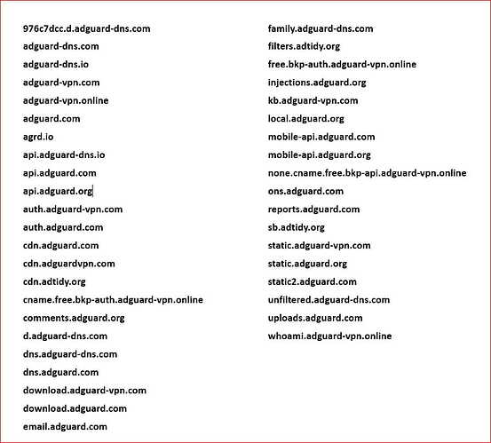

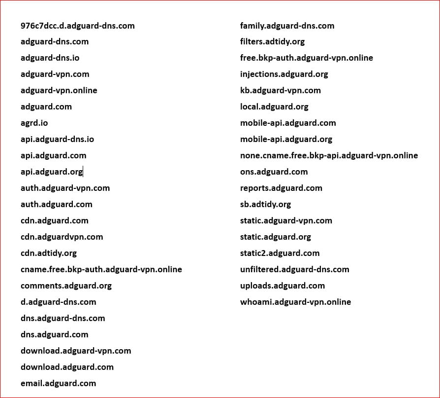

I did some research and came to a clear conclusion: Adguard belongs to the russian intelligence services. FSB do not invest money in this system in vain, they need such a system.
If anyone doubt it, just look at what a powerful server infrastructure they have built. To do this, it is enough to look at the information on the otx.alienvault.com by domains:
Most of servers are at cloudflare, but the key servers are in terrorist state russia.
So I decided not to waste my time on Adguard and just blocked “cunning” user until he removed russian crap from his phone.
