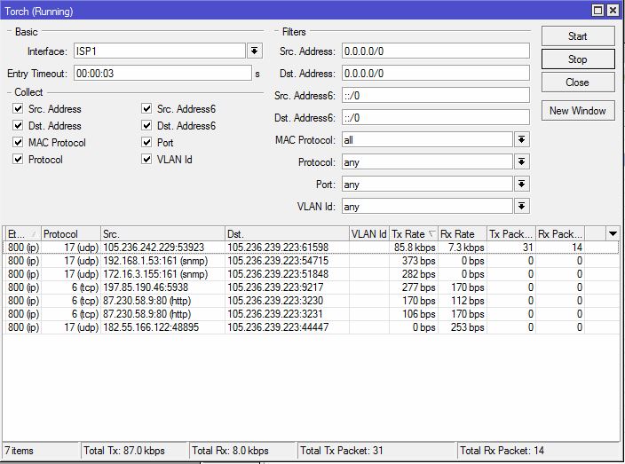

And where exactly are you seeing this “excessive traffic”? Have you tried to torch it?
With Torch, thats where I get all my info. Its mostly https traffic. Funny thing is I changed my ISP account to a different account but on the same ISP, still the same problem, If I look at the interfaces, theres only traffic on my bridged and ISP interface and my wifi where im connecting from, the rest stands on 0.
Post a screenshot
Sent from my SCH-I545 using Tapatalk
At this moment theres no problem, the network is quiet as you can see, I anyway took a screenshot and will do again when the traffic starts jumping again. Just to show you how I scan. Unlike normal traffic that fluxuates, this problem traffic stays more or less solid at a high speed. and I can see that its not coming fromt he LAN.

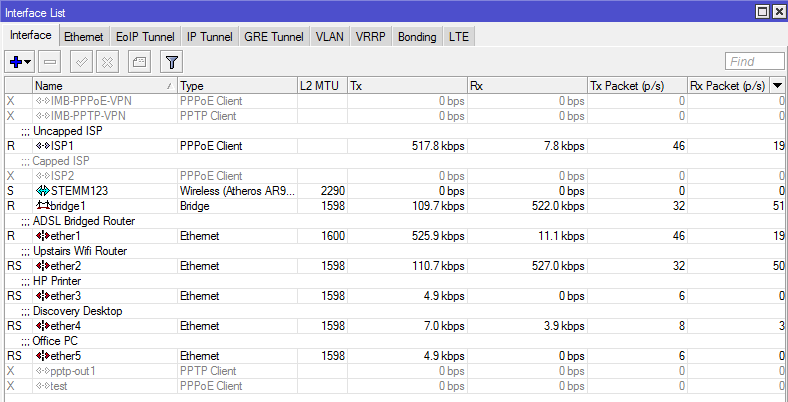

HI,
Here is an example of the Traffic thats killing my internet connection:

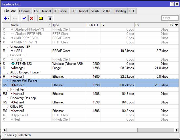

Another Example, only a minuite on:
Then Again another minuite from that one a totally different IP:
Someone on upstairs router is streaming video from Amazon?
Traffic comes in from ISP1. Traffic goes out ether2, “Upstairs WiFi Router”.
IP addresses of high traffic connections belong to Amazon.
Some machine connected to Upstairs WiFi Router requested the traffic. The NAT rule permits the traffic. Working as configured.
