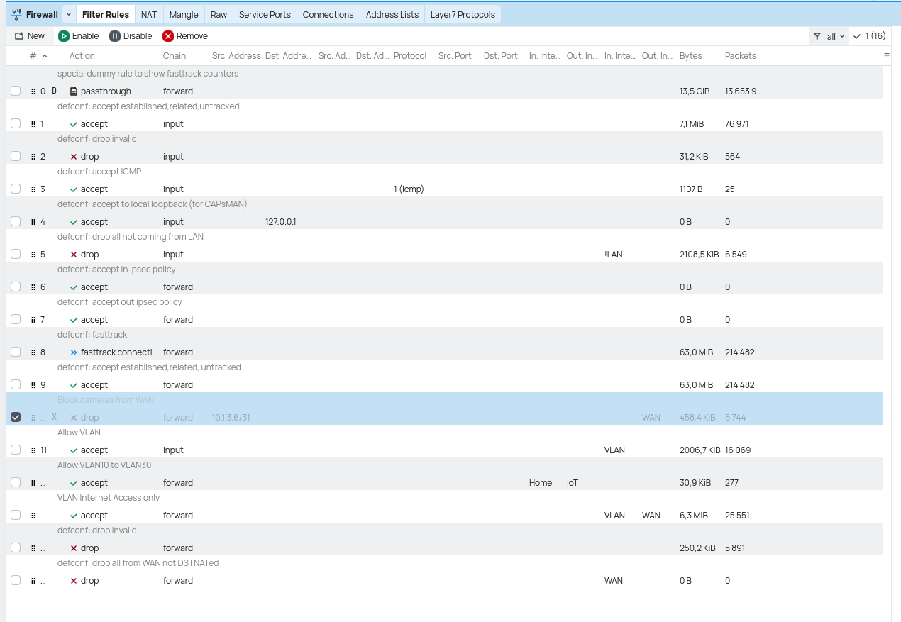

Firewall forward rule, source address list consisting of your cameras. Destination address !YourLan and drop it.
You drop anything not going to your lan from the cameras. JD.

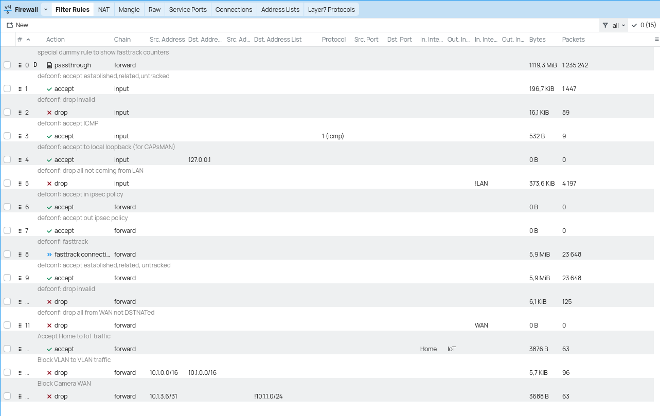

Not working, are these right? Home network is 10.1.1.1-254 which should have access to cameras.

If your VLAN interface list contains Home, IoT and Guest interfaces, insert the following rules between the last two at your initial screenshot:
chain=forward action=drop src-address=10.1.3.6/31 out-interface-list=WAN
chain=forward action=accept in-interface=Home out-interface=IoT
chain=forward action=drop in-interface-list=VLAN out-interface-list=!WAN

Firewall rules are processed top down, I think the LAN > IOT rule is interfereing, try dragging the rule you created on my reccommendation to the top, if it works, presto, knit it back in to somewhere sensible (or drop it down the list until it stops working and then move it bac up one.
Thanks @anav and @Steveocee. I got it working now with your help. The only problem is that now I can’t seem to access the cameras from local net. The cameras are TP-Link Tapo C100 and I’ve read that they have to be on same subnet for local access to work so I have to figure something out what I want to do.
Please explain, “cannot access cameras from local net” ???
Do you mean you cannot view cameras in t he 10.1.3.0/24 subnet from your PC in the 10.1.1.0/24 subnet ??
Please post latest complete config!!
Yes, exactly this. I can access other devices in 10.1.3.0 subnet from 10.1.1.0 but these cameras don’t work from the Tapo app. I can ping them but not see the video stream. There’s multiple discussions about this same matter.
