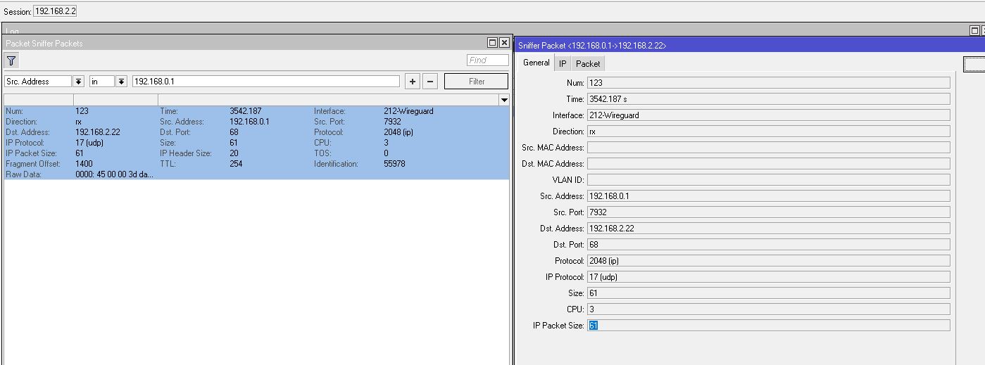

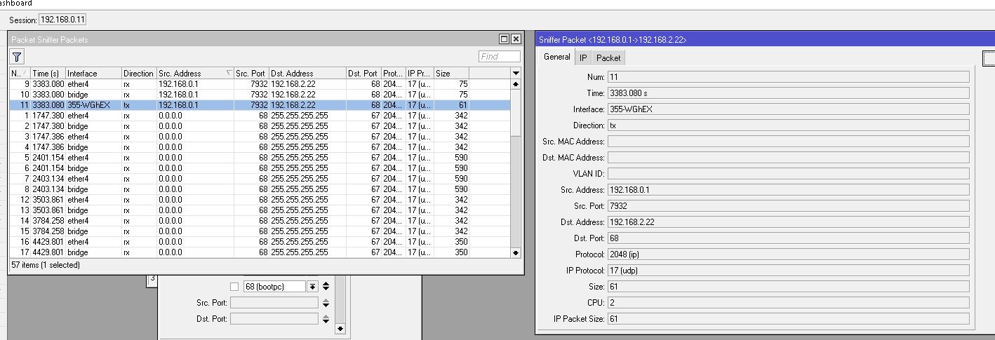

I ran a packet sniffer overnight collecting all port 67 and 68 traffic on all routers.
Sure enough, I found a few packets destined for port 68 that traverse the WG connection and originate from the Ubiquiti UDM and destined for my main work computer (very odd, as that computer does not run a DHCP server).
It’s not important – I’m just curious.
192.168.0.1 is the UDM
192.168.0.11 is the hEX behind the UDM that provides the WG connection
192.168.2.22 is my main work computer
Src port 7932???
Usually are port 68…
It’s a scan of some form…

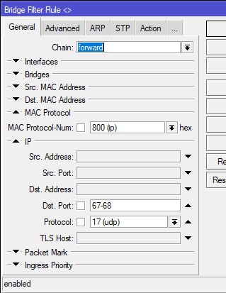

I usually in such situations, I block forwarding on bridge udp ports 67-68. Then packets from other DHCP servers are not forwarded through the bridge and everything is stable.
What do you mean in such situations? When does this occur?
When several offices are connected into a single network.
The VPN interface is added to the bridge
PS If a wrong DHCP server or client appears on one of the router ports in one of the offices, it will not affect the entire joined network.
