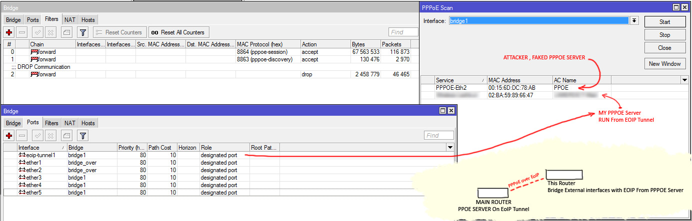

I have problems with some clients run pppoe server on their network and catch our clients pppoe packets username / password
I’m using Central PPPOE Servers and and transfer each pppoe server to second routers via EoIP Tunnel (each PPPOE Server run on each EoIP)
the below image is one of my second routers give a pppoe server from EoIP Tunnel and bridged with other external ports but one client run a pppoe server on he’s network and catch username/password of my customers.
I’m using a some filter rule on bridge filter but don’t work and can be see too on pppoe scan tools :
HOW can I Prevent this problem ? or block clients to run a pppoe server (or drop pppoe server packets from clients to router ? )
thanks :wink:

I was disable the default forward on wlans and use below bridge filter rules for client isolation and accept my pppoe server :
[admin@MikroTik] /interface bridge filter> print
 0   chain=forward action=accept mac-protocol=pppoe
 1   chain=forward action=accept mac-protocol=pppoe-discovery
 2   ;;; DROP Communication
     chain=forward out-bridge=bridge1 action=drop in-bridge=bridge1
but don’t know how can I client isolation with below items :
