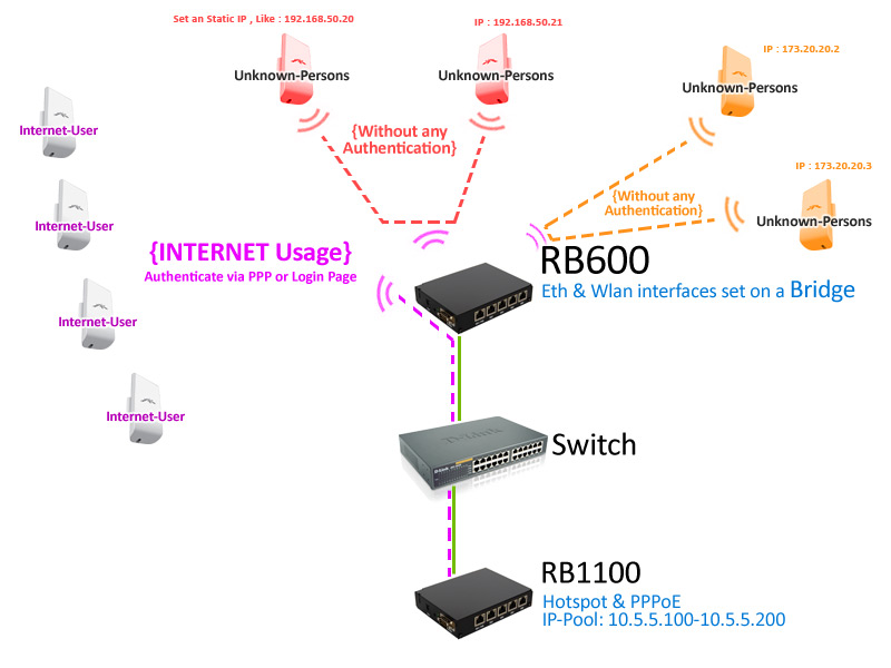

Hello My Friends
Anyone Can Easily Create a Virtual Network With He’s Friend via My Wireless Devices :confused:
Example : Connect to One of My AP , Set an a Static IP (like 192.168.20.1) and Set 2nd Comouter IP 192.168.20.2 (on 5KM Away)
Please See The Attached Image

i Set The “use-ip-Firewall to YES” on RouterBoard Bridge , but Still the Problem .
i Test it , 192.168.20.63 can Ping or Connect to 192.168.20.70 (<-- This is an Example IP Address)
Are those two IP addresses connected to DIFFERENT APs? If yes, write firewall filters in the ‘forward’ chain to drop traffic between customer IP addresses after permitting traffic between customer IPs and their gateway. If no, you’ve been making mistakes implementing what you’ve been told in this thread, and should post your configuration.
