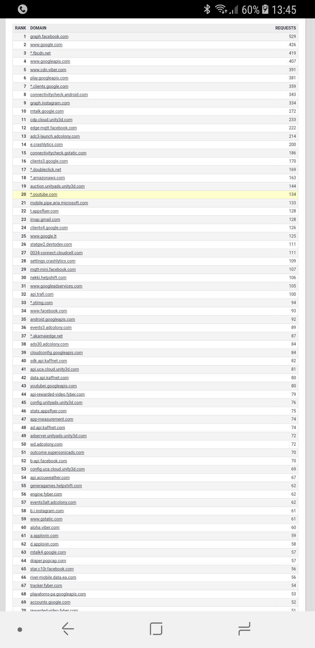

As he mentioned before. Dropping layer7 and adding his pages to L7 list is enough. and woking… BEST SOLLUTION. Point is just finding all pages tried to be reached.
Why didn’t block you youtube in Ipad but yes it blocked when you used “ytimg”?
