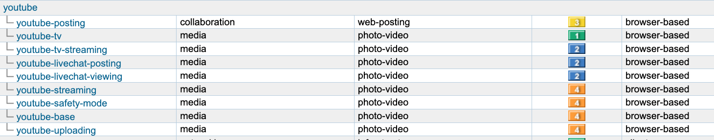

Even on a PaloAlto, which is considered a very good (and certainly very expensive) NG Firewall, you can´t distinguish between shorts and normal videos.
These are the current categories:
youtube-posting

You can check yourself here: https://applipedia.paloaltonetworks.com/

I’m not quite sure how to interpret this, considering that streaming is indicated as both “completely fine” and “partly less fine” without any explanation. Besides, Palo Alto also supports SSL “middle-man” inspection (i.e., decrypting, analyzing, and then re-encrypting) of the traffic, but this requires a pretty complex setup, as I explained above.

These are different application categories, which you can use directly in a ruleset or use the risk score or the other groupings.
You could just allow youtube-livechat, but decline youtube-streaming. As there is no extra category for Youtube Shorts, the firewall would categorize it as youtube-streaming probably.
This is partly dependent on SSL decryption, the Firewall would just categorize everything as youtube, if you have no SSL decryption and there would be no flow marked as youtube-streaming.
