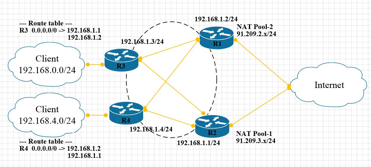

good day
I put together a test bench as in the picture above.
There are two paths in the routing table for route 0.0.0.0
Now tell me how to configure R3, R4 (CCR1036) so that there are different gateways for route 0.0.0.0.
