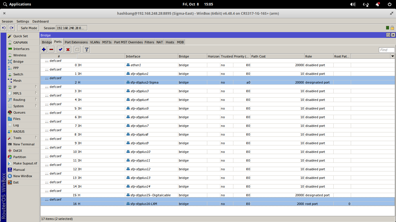

2 32768.084f-0ab2-1eff 2010 2 20 15 XGigabitEthernet0/0/3 …towards crs sfp 16 (this root bridge connects to huawei B thru crs)
the value is 2010 and plz see in screenshot of winbox its 2000 and 20000 from where 10 is coming ?

The screenshot showing sfp16 role root port indicates this is the path to the root bridge, it is not the root bridge itself - something else is.
The path costs are shown in the screenshots, and you have actually set some as the configuration has entries such as path-cost=20000. These are the cost on that particular point-to-point link, there is separately a calculated root path cost which is the sum of all the point-to-point link costs back to the root bridge.

sfp 16 is root port but no cost shown
