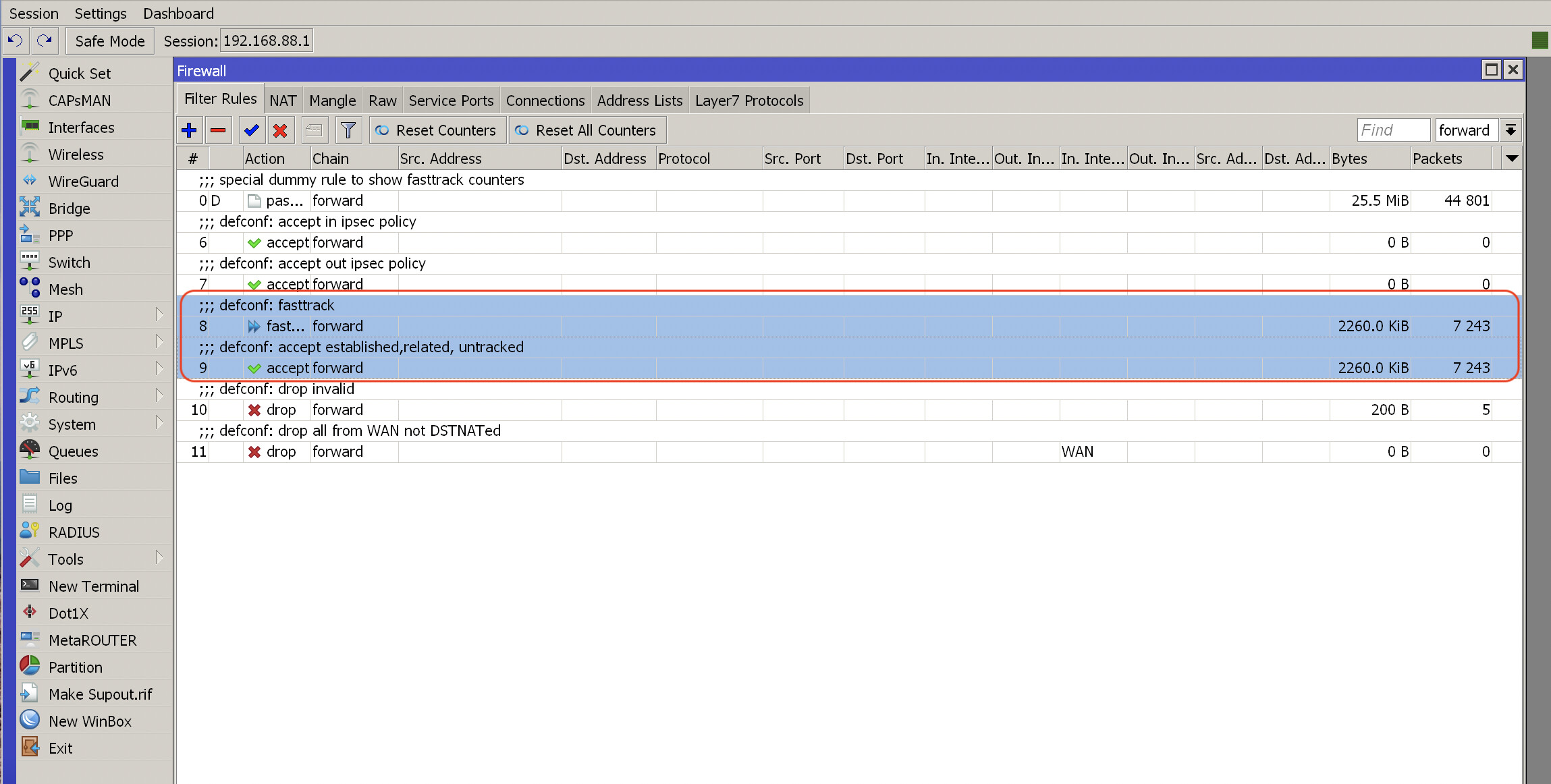

I recently migrate one of my router’s to RouterOS v7rc4 version. I notice fasttrack counters (either packages/bytes) are the same for this firewall rule and for the subsequence one that accept new traffic in forward. If I’m not wrong, these counters should be different when fasttrack is active, due to the fact that traffic related should be entering through the first rule, and not the second one, hence the first rule should receive much more traffic than the second one. Is my assumption wrong?
Attached my configuration, which is just a default config from default init script.

If you navigate to IP → Settings in Winbox, you see a section toward the bottom that will indicate if IPV4 fasttrack is active. It will also show you the number of bytes and packets that have been handled by fasttrack.
Yes, your assumption is wrong. Fasttracked connections don’t hit the firewall anymore except for rule 0. If you look at your rule 0 in your firewall in your screenshot above you see 25.5MiB of data. That is the counter rule (“special dummy rule to show fasttrack counters”) that shows how much is being fasttracked. So I can already see from your screenshot that fasttrack is working fine.
You’re absolutely right. I just reset another router with 6.49 and is working the same way. I don’t know why I had the feeling these numbers were different before, but it might be the case I had it like this because I stopped some of the rules at some point, therefore the difference in counters.
Thanks both for the quick reply!
If the Fasttracked connections don’t hit the firewall anymore, why do we need the “fasttrack-connection” rule?
When certain connection matches selection critera of this rule, action of this rule “registers” the connection for fasttracking. And this applies to connections that are not fasttracked (yet). Without such rule fasttrack doesn’t work at all. Sometimes it’s good to exclude some connections from being fasttracked for various reasons and it’s good to have possibility to fine tune selection process.
The top-most “rule” which shows meaningfull counters is a dummy rule (as noted by a comment for this rule) and doesn’t affect actual packet flow of any packets.
Thank you. That makes sense.
