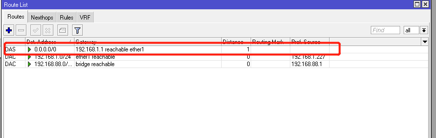

I have two ISPs internet services and both of them are DHCP. I have hEX RB750G. the simple configuration is below
ETH1-3 in the same bridge (LAN).
ETH4: WAN2 (ISP2 internet connected)
ETH5: WAN1 (ISP1 internet connected)
My question is how to auto comment ISP1’s uplink as WAN1 in IP Route 0.0.0.0/0 when ETH5 is plugged in and up . and comment ISP2 as WAN2 when ETH4 is plugged and up. I know I have to write script in DHCP CLIENT section to achieve it.

Maybe it is easier to search for a default route related to the interface when it changes? Something like
ip/route/find where (vrf-interface=wan1 and dst-address=0.0.0.0/0)
thank you, bro. I tried your given code, but it doesn’t work.
the 0.0.0.0/0 pop up in IP ROUTE is without commented it as WAN1.
What I mean was that rather than add a comment the route, saying it is WAN1, then just use the above command in netwatch.
If you insist on adding a comment you might be able to do so by adding a script that does it in the DHCP script client script.
that is what i am doing now, but my script i wrote doesn’t work. do you know how to write the script and place it to DHCP Client Script section.
