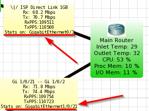

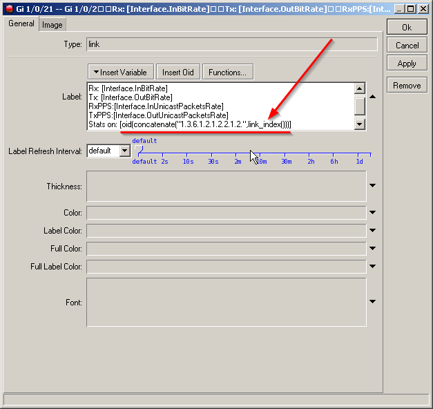

If you would like to have such a picture
you should use not [Interface.Index], but link_index()
the code should be
Gi 1/0/21 -- Gi 1/0/2
Rx: [Interface.InBitRate]
Tx: [Interface.OutBitRate]
RxPPS:[Interface.InUnicastPacketsRate]
TxPPS:[Interface.OutUnicastPacketsRate]
Stats on: [oid(concatenate("1.3.6.1.2.1.2.2.1.2.",link_index()))]
