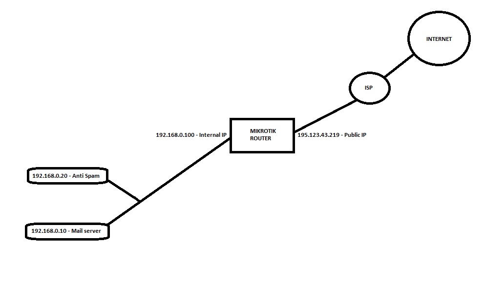

192.168.0.10 - Mail server
192.168.0.20 - Anti Spam
192.168.0.100 - Internal IP
195.123.43.219 - Public IP

2.) Where are you trying to access the server from? Behind your router? If that’s the case, NATing back to the same subnet you are on doesn’t work too well, it is easier and cleaner to place the server(s) on a different subnet and have them in a kind of a DMZ. If you have you have to keep them on the same subnet, use hairpin nat.
http://wiki.mikrotik.com/wiki/Hairpin_NAT
Setup is as per attached…
