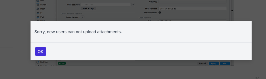

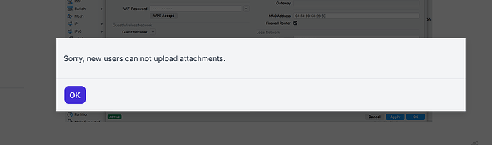

this forum is not allowing me to upload files.. :roll_eyes:
Then don't upload files.

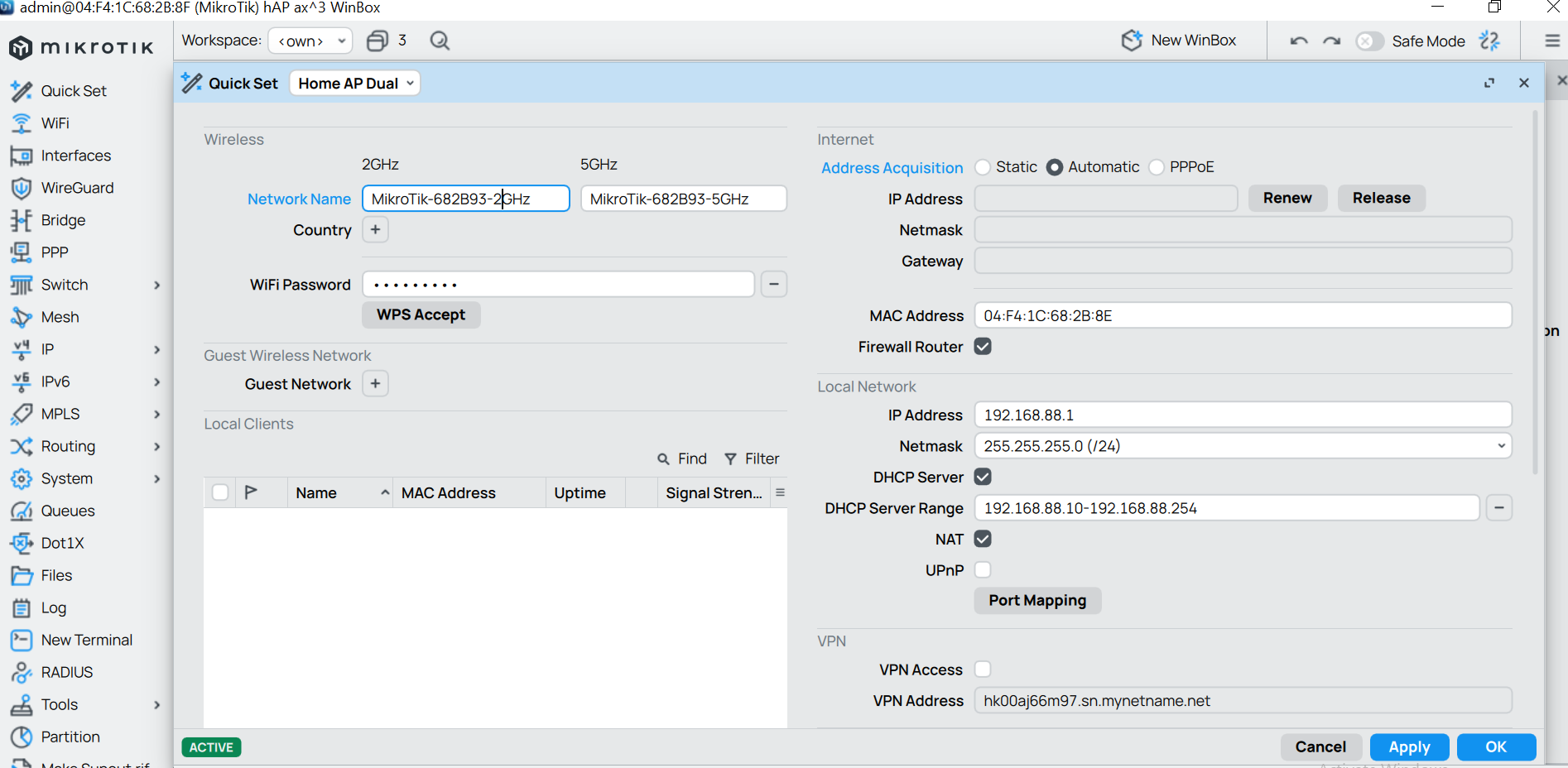

QuickSet = NO HELP.
Do not use QuickSet, forget QuickSet.

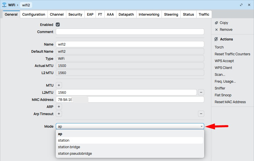

To use station mode, the Wifi interface must be removed from the bridge.
You can then use it (wifi interface) as the gateway or WAN interface (eg. with NAT or routing for devices behind the AX3)
station bridge mode allows you to keep the bridge and bridge the local bridge to the rest of the network but only works with other Mikrotik AP’s running the WiFi package (as opposed to wireless)
Note: it also works with a small set of other vendors, eg. Some Fritzboxes are compatible.
station pseudobridge is a bit of a hack, it allows you to keep the Wifi interface on the bridge. It often works, but you must at minimum turn off rstp on the bridge port of the wifi client. (easiest by turning off rstp completely on the client) It may also only be useful for ipv4. (There are likely also other ifs and buts)
Forget about QuickSet. Use normal configuration and be sure to use the station bridge mode if you want to add the wifi interface to the bridge.

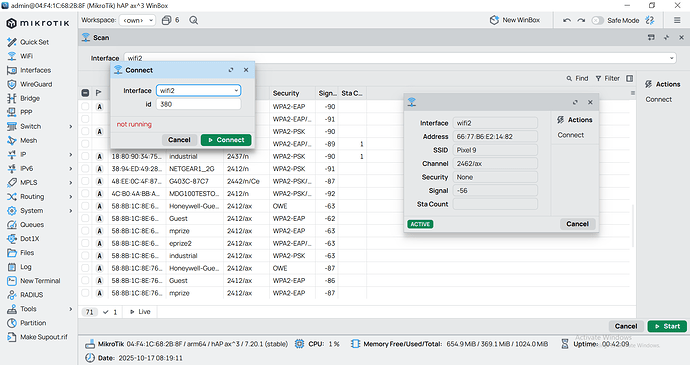

The process is quite simple:
  • WiFi -> double click the interface (e.g., wifi2)
  • click Scan to find your AP, in the Scan window and while running the scan click the AP and click Connect
  • Go to the General tab in the original window and set Mode to station bridge
  • switch to the Security Tab
  • set the Authentication protocols and Passphrase
If the interface is not in the bridge, add it to the bridge:
  • Bridge -> create new bridge (if not already present)
  • Click Ports tab and add all needed ports (including the wifi port)
Assign IP address to the bridge via DHCP Client (if needed)
  • IP -> DHCP Server -> +
  • Interface: bridge (not the wifi interface, but the bridge)
Or use the static configuration (if needed)
  • IP -> Addresses -> +
  • Interface: bridge (no the wifi interface, but the bridge)
  • IP -> Routes -> +
  • Add default gateway accroding to your needs
That should work without any problems. If you encounter any problems, paste your configuration and detailed description on what you want to achieve :slight_smile:

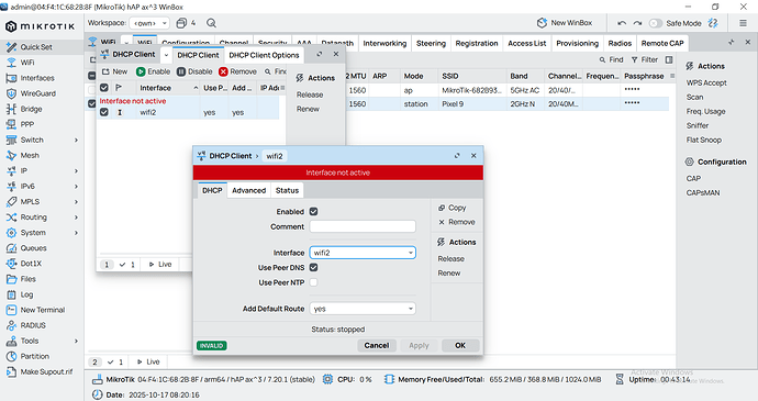

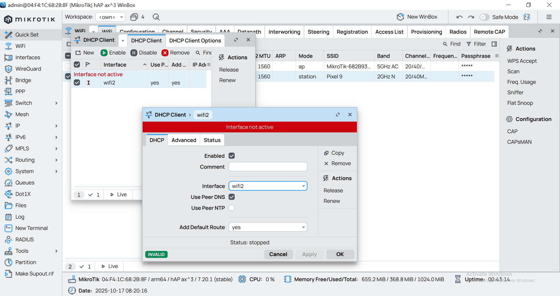

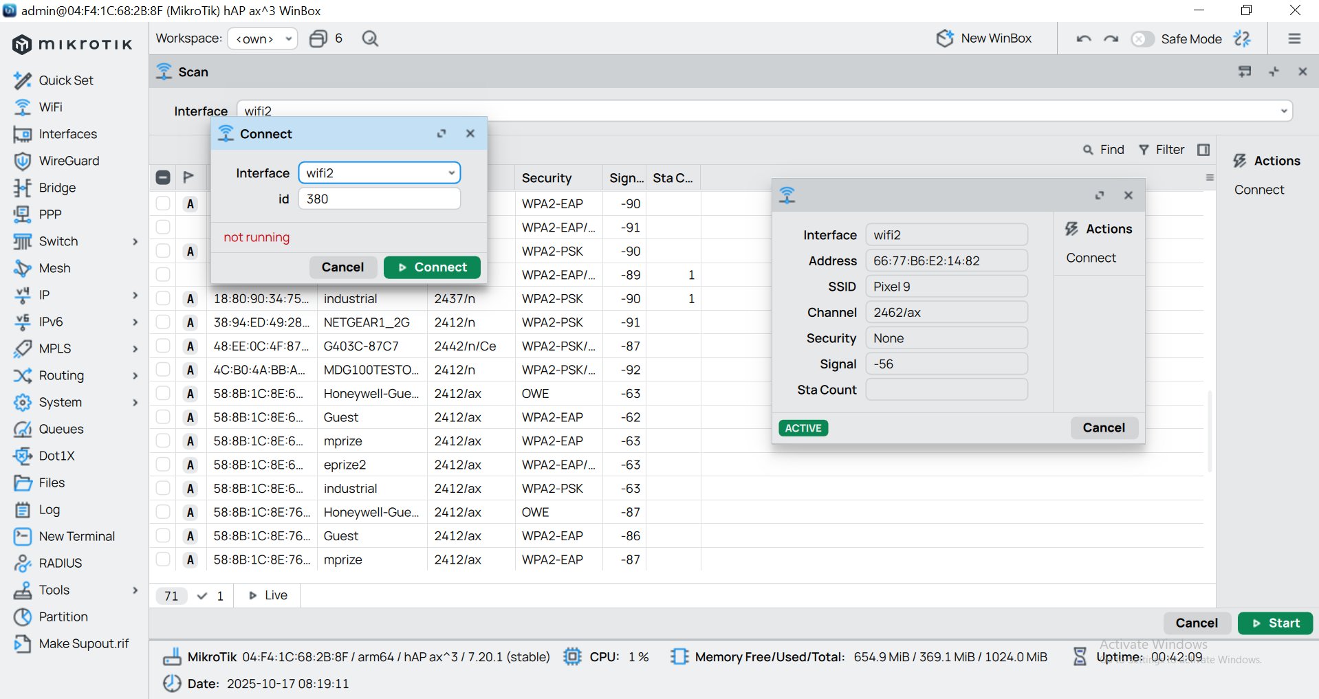

thank you for the inputs,
I tried the steps you mentioned but when i wifi scan and tring to click Connect, its unale to connect.
a small windows blinks and go away .. nothing happens after that.
Below is the router configuration i am using,
