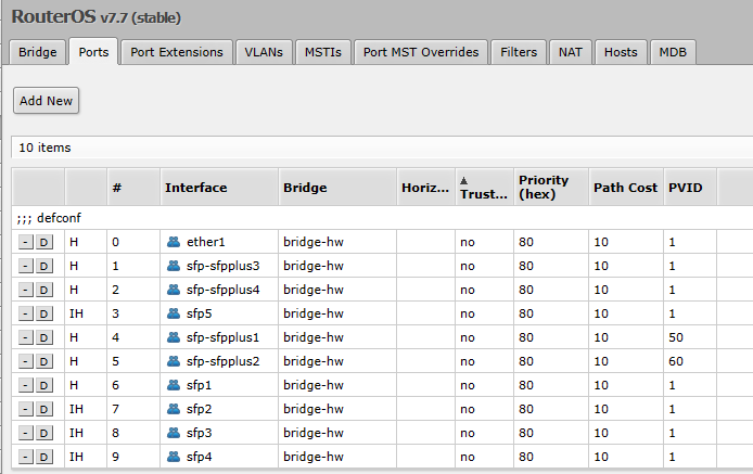

I was a bit surprised by this - see my bridge port config down below.
With RSTP, what would end up happening is SFP1 would get nominated by the RSTP as the root-port, the rest as alternates. If I were to lower path cost on, e.g. SFP+3 to 0, then I would get that port to become the root, traffic there (and only there) would be forwarded but at the cost of locking myself out (SFP1 is the port I am using to access the router). I observed similar behaviour if I tried to alter path costs on the Dell 8024F (this is, from what I understand, because these ports are facing away from root bridge, which is on Dell 8024F).
Further, SFP+1 and SFP+2 were always marked as designated. Based on what you explained, I would assume this behaviour is because all ports (except SFP+1 and SFP+2) are belonging to the same PVID?

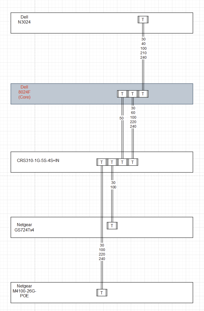

I am attaching a sketch of my full LAN layout - since this is basically daisy chained switches, I see no real need to use (R)STP but if I still wanted to, how would one go about fixing this problem above?
