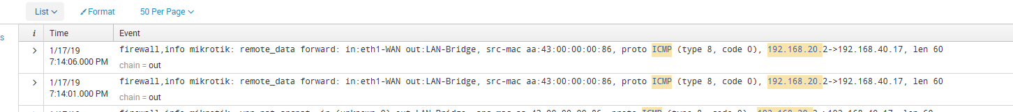

add action=accept chain=forward log=yes log-prefix=remote_data src-address=\
    192.168.20.0/26

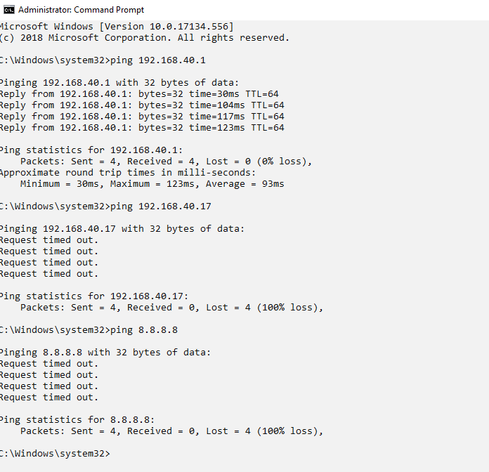

So I can easy establish Remote Access. Also it’s possible to ping router’s gateway 192.168.40.1
No luck truing to access (ping, SMB, HTTPS) any internal sources, but from logs I can see that trafic was allowed.
Also no luck truing to access (ping) any external (ex. 8.8.8.8 ) sources.

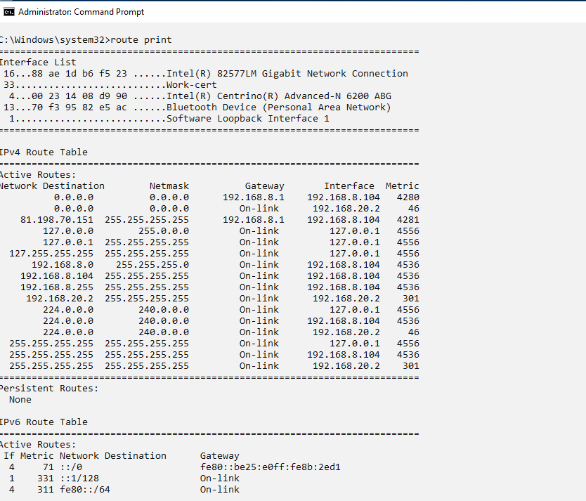

output of route print on Remote Access client:
Would you kindly to help me fix this issue?

So issue was in firewall on remote host :slight_smile:
