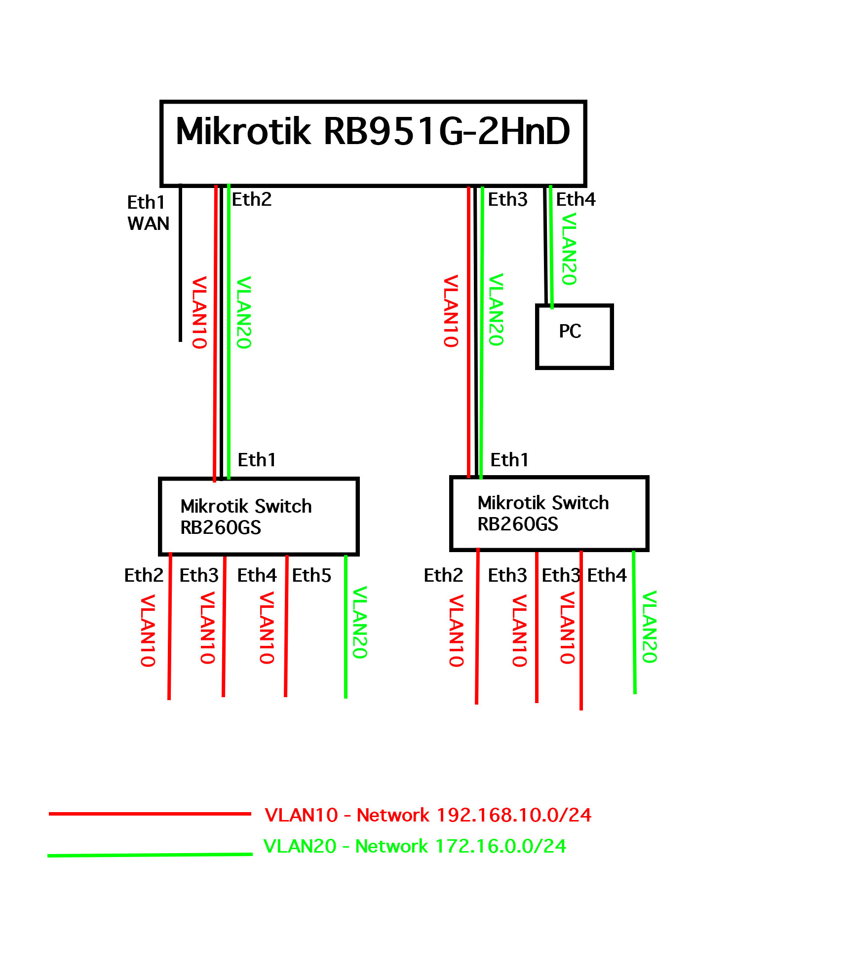

I’m a complete beginner in VLAN. I would like to configure my router as shown in the picture. Can anyone help me? And also MGMT vlan for access to devices. I don’t know.
Thank you.

I recomend to start by reading this excellent tutorial. After you do it and still have troubles, come back with concrete questions.
I sympathize with your endeavour. I have a similar setup and it took some time to get there. The article noted is excellent.
Once you have a start on a config for the router you can post the config for us to have a look at.
/export hide-sensitive file=yourconfigsep31 just make sure you put in fake Ip addresses for the public facing WANIP (the one from your ISP)
The 260GS switches are not the friendliest beasts IMHO. Once setup correctly they work fine but getting them there is bound to drive you a little nuts.
Again I can certainly share the knowledge I have of my setup if that help you with your efforts. No sense in doing that though until the router is configured properly.
