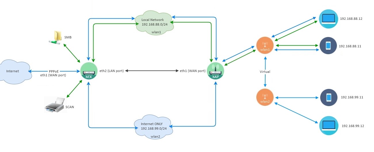

hEX lite distributes the Internet and LAN (through the eth2 port), but hAP lite receives only the Internet from it (through the eth1 port).
Me need ideas on how to forward local network, so that it is possible to create a virtual wlan2 that should not have access to the main local network.
As much as I have not tried, I can’t lift the virtual network so that it has Internet access …
All instructions with the old firmware are not suitable, since the Out port does not appear in them. Inteface List: WAN

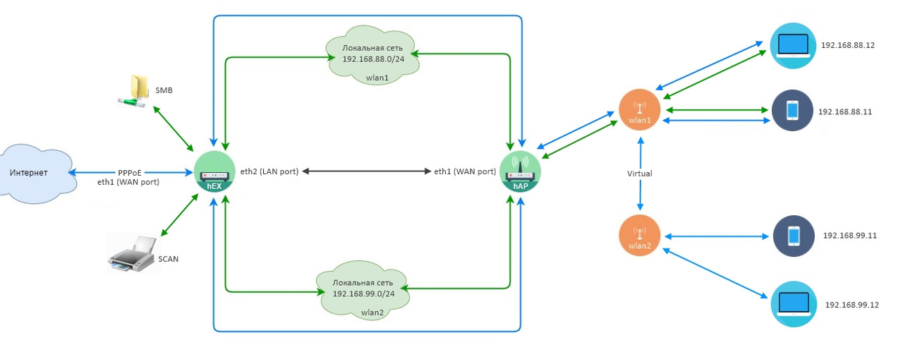

Made a scheme for understanding in the image:
Old version (not right): https://i.postimg.cc/NF9xvZ5z/sheme-primer2.jpg

In solving the problem will help EoIP or bridge?
p.s. i indicated two different subnets 192.168.88.0/24 and 192.168.99.0/24

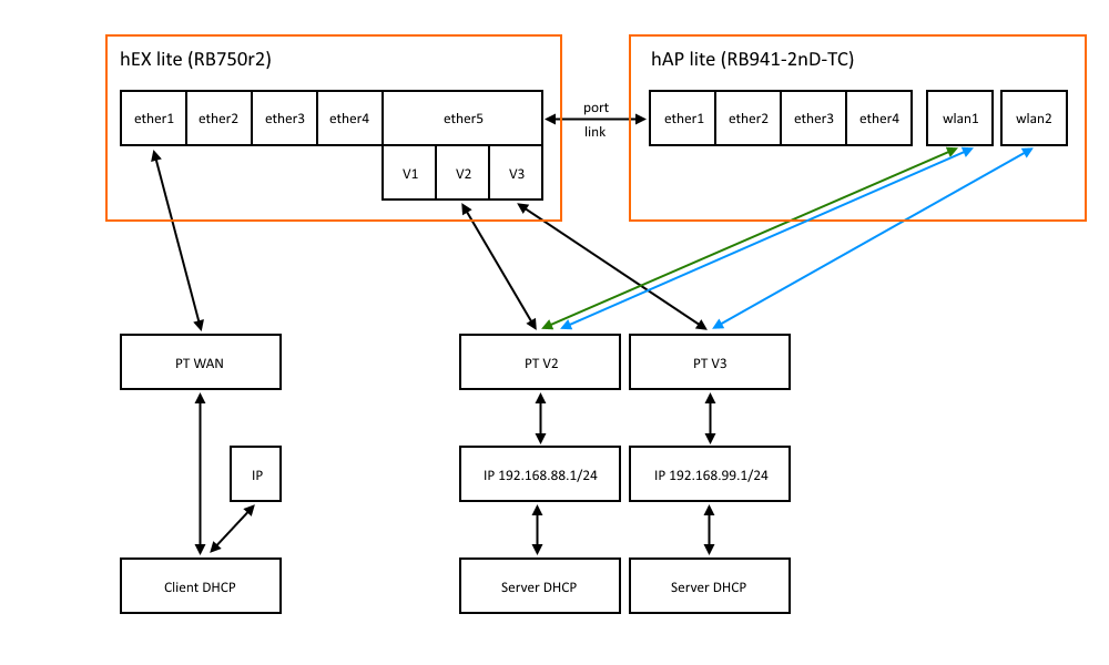

I would use vlans for all my subnets and separate traffic that way.
vlan10 .88
vlan20 .99
I gather .88 is like for home users and .99 is like for guests.
I do something similar for my router and capacs…

You need to have LAN access on the hAP to the hEX. hEX will be DHCP server for all. LAN hEx and LAN hAP are bridged.
Fastest way to do this is connecting the hEX to the ether2 on the hAP, and replace the DHCP server on the bridge on the hAP with a DHCP client.
<-Internet- WANport - hEX- LAN port (ether2) - LAN port (ether2) - hAP - LAN ports (wlan1,wlan2) →
(Or change ether1 from WAN list to LAN interface list,. add ether1 to bridge, remove DHCP server from bridge, then you can use ether1 on the hAP, because it is now identical to ether2,3,4 …)
(DHCP client must be on the bridge, not on the ether(1))
