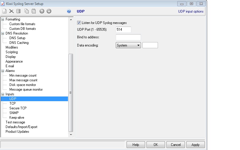

I also use Kiwi on my desktop machine to collect some logs from my home MikroTik box.
I have deafult rules (one is to display in your Kiwi client, another one is “Log to file”), and I’ve edited “Log to file” to make different files monthly by entering “J:\path\to\folder%DateY4-%DateM2 NAME FOR YOUR LOGS.txt” to file path. Apart from that, I’ve entered DNS settings and set it to listen on UDP port:
On MIkroTik I’ve set remote logging facility to match

It’s pretty straight forward:
Enter MikroTik’s address that you connect to from your PC (you have to make it reachable).

Finally i got it, i check the error logs and i find in TCP i put the WAN IP in kiwi syslog configuration. For which binding failed error was showing. Thanks for all of your help
