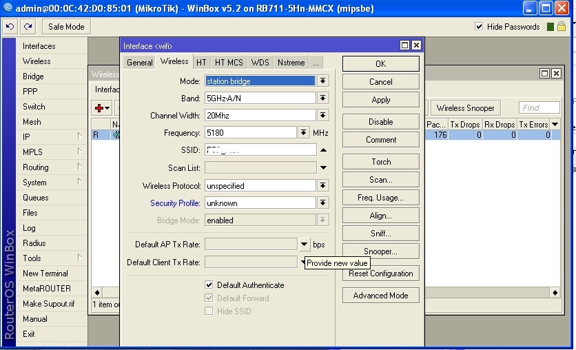

Is there any special configuration to connect the “RB711G-5HnD” to a NanoStation M5?
Mine is not connecting as Station Bridge
but as Station, it is connecting
when i turn it to Station Speudobridge, it work
but I have used a “NanoStation LOCO M5” Here using the same configuration to connect “OmniTIK” where the “RB711G-5HnD” was connected

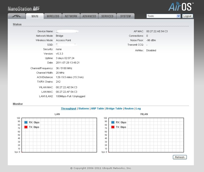

What mode you have on Nanostation? 802.11 A or 802.11 N?
Try RB711G upgrade do 5.14 and change channel width to 20Mhz.
Airmax is disabled - it should work with mikrotik
Hi honzam!
It is a “NanoStation M5” A/N mixced
The channel is 20Mhz.
Airmax is disabled
and it is not working !
Alex
And what mode on M5? single N or 2x2 ?
Did you reset the M5 and configure it again from scratch ?
I had often problems with that. Best is to apply every change on one site.
Also don´t upgrade to 5.3.5 there is a bug in the channel/frequency country settings.
Once you have finished the config and teh device is running as expected, save your config and update to 5.3.5, but never reset to defaults :wink:
