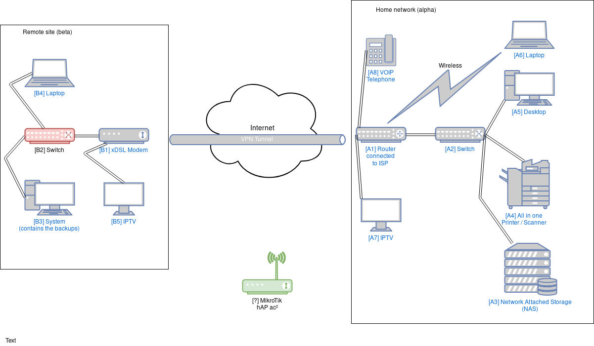

I have created a diagram to visualize the network topologies. As you can see both networks are small and simple.
The remote site is drawn on the left and my home network is drawn on the right.
The A2 Switch in my home network is a MikroTik hAP ac² with the WiFi disabled.
I am considering to replace the switch [B2] on the remote site with a new MikroTik hAP ac² [?].
Then the new MikroTik hAP ac² [?] at the remote site would need to be configured in such a way that it can connect to my home network trough a VPN tunnel.
I am not sure what the best approach is to wire and configure both networks but I would like to be able to use hostnames in my backup scripting instead of ip-addresses that might change.
OK, it looks fine. If it wasn’t for the IPTV at site β, I would recommend you to switch the modem there to bridge mode and get the public IP assigned directly to the hAP ac², however making IPTV work over Mikrotik is another can of worms.
So if you let the hAP ac² get its WAN address from the modem, and give out IP addresses from another subnet on its own LAN, you don’t need to touch the routing on the PCs because they will send everything to the Mikrotik which will sort it out. You will end up with double (or even triple) NAT, but the negative effects of multiple NAT as compared to a single one are overestimated so no worry there.
Or you may let the hAP ac² become yet another device on the modem’s LAN, with a static address outside the range assigned by the modem and not running its own DHCP server, and manually configure the routes on the PCs to send the traffic for site α via the Mikrotik and the rest via the modem.
Yet another possibility is functionally the same like above, except that you disable the DHCP server on the modem and enable it on the hAP ac² instead, and let it dynamically push the routing table to the PCs (using DHCP, you can provide not only the IP address of the default gateway but also a complete static routing table).
The same applies for the hAP ac² at site α, but there it becomes a tiny bit more complicated as the laptop is connected wirelessly, so I’d recommend the last option above if A1 will be flexible enough to keep acting as the wireless AP but give away the DHCP server role.
In any of the “two and a half” cases above, the hAP ac² at site β will be configured the same way as a VPN client of the hAP ac² at site α.
Mikrotik allows to define static DNS items which are taken into account first, so yes, if you configure the PCs at both sites to use their local Mikrotiks as DNS servers, you can do this. Again, the DNS server IP can be pushed via DHCP, so you can do that in a centralized way.
