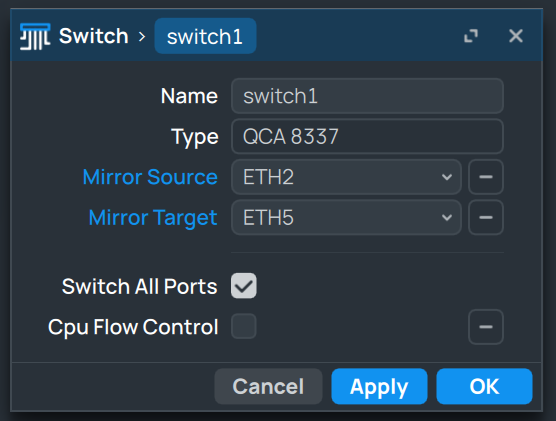

have you tried mirroring?
Still dont get what you try to do with a “processing host”, but why not this:
And stream to your “processing host”.
Thank you so much for replies!
@BartoszP this is a very good option if someone has physical access to the network. I don’t have it unfortunately, so this is dead end as RouterOS does not support, AFAIK, eg. ERSPAN.

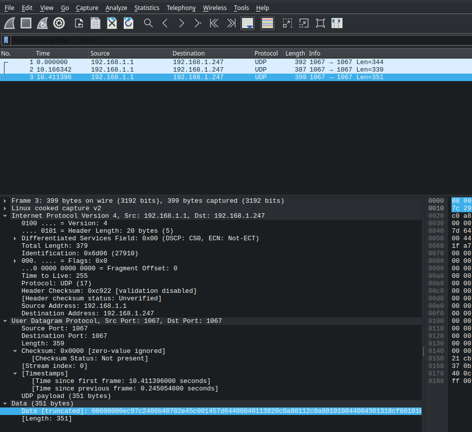

Tcpdumping the inbound traffic would result in some packets which can be open in Wireshark but are not particualrly usable for my code :slight_smile:
Ok, I implemented this TZSP protocol in my software and it works fine, but…. I fail to write any rule which would ever catch ANY UDP packet produced by the Mikrotik DHCP server :confused:

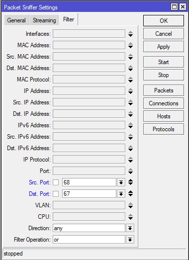

And Sniffer config also gives me hard time, won’t send data today :slight_smile:
Let’s call it a day, I think that this is worth a Mikrotik expert look or supout :slight_smile:
