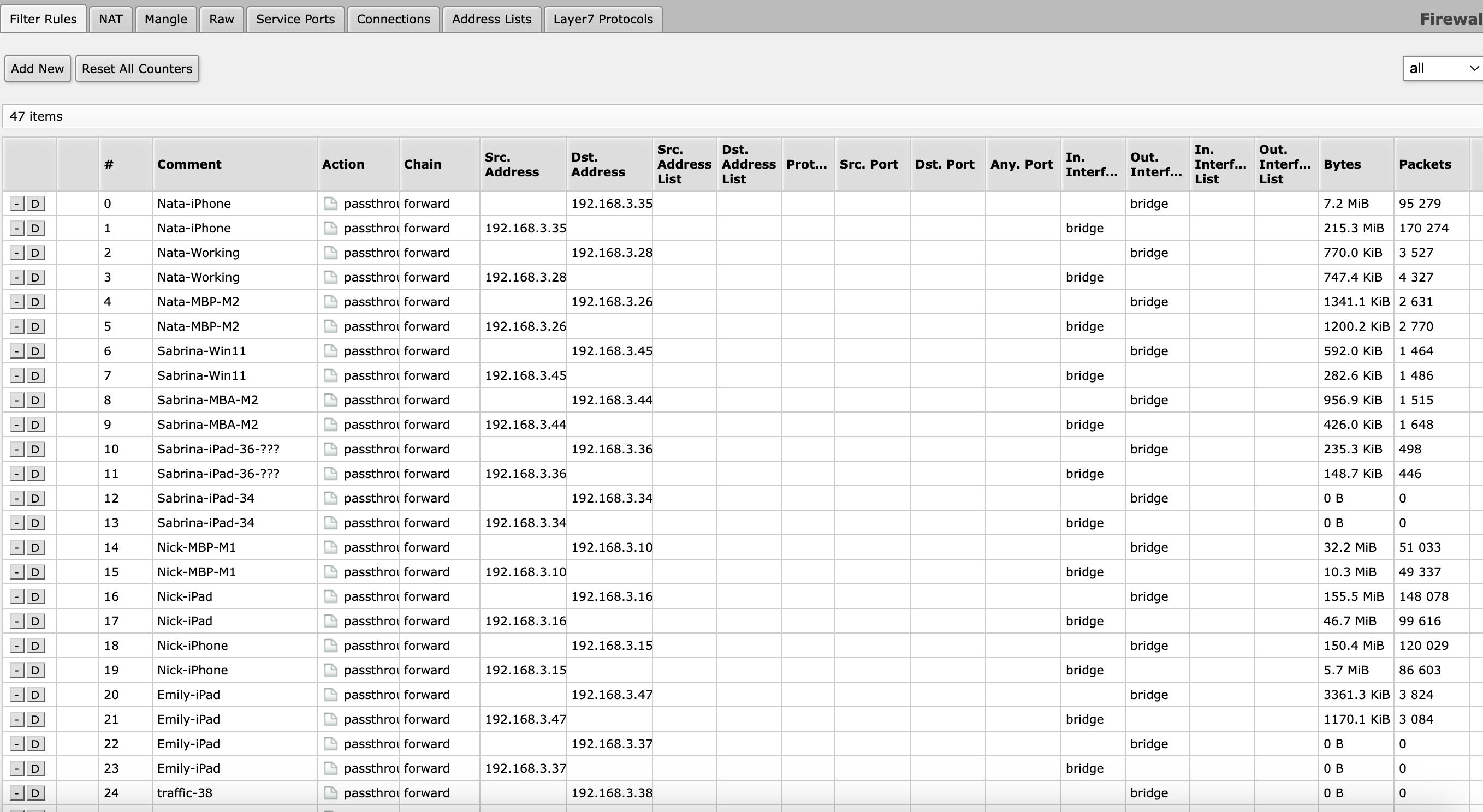

For a small number of IPs that you want to check, you can create a passthrough fire wall rule that does not do anything except count packets. I have a bunch of those rules - although generally most are disabled except when I am doing some specific test that requires that particular rule. This would not be overly practical for monitoring hundreds or thousands of IPs. The two rules below will give packet and byte counts for packets to and from the address 192.168.104.41
add action=passthrough chain=forward comment=\
    "Counter for inbound packets towards CRC Johnstone DMR on VLAN 104." \
    connection-state="" dst-address=192.168.104.41 out-interface=VLAN_104
    "Counter for outbound packets from CRC Johnstone DMR on VLAN 104" \
    connection-state="" in-interface=VLAN_104 src-address=192.168.104.41
Looking at it in WinBox, shows that there is not much activity (not being used at this time)…
