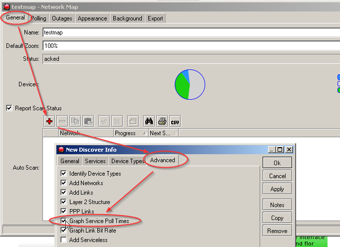

Hello.
Gsandul,
this is the easy solution but I am looking for the complex one :wink:
I was looking for a way to create a probe that does not graph from the beginning - I am running a “auto discover” every 24 hours and new services are added if interfaces come up, etc.
My interfaces never need to be graphed, I am graphing bandwidth via the links (on the map)
Also I would just be graphing a 1 (up) or a 2 (down) so this is not neccessary.

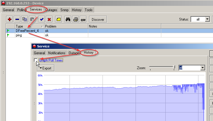

Otherwise I just check once in a while and disable graphing in bulk.
thanks
Andreas

Will this work for you?
Or some services should be graphed and some - not?
:slight_smile:
If so, create 2 scan shedules, one with disabled authograph services and the other whit enabled authograph services :slight_smile:

I admit, enabling a few (CPU/RAM/Temp/etc.) is much less work than disabling a lot :slight_smile:
Will follow that way. Thanks!!!
Andreas
