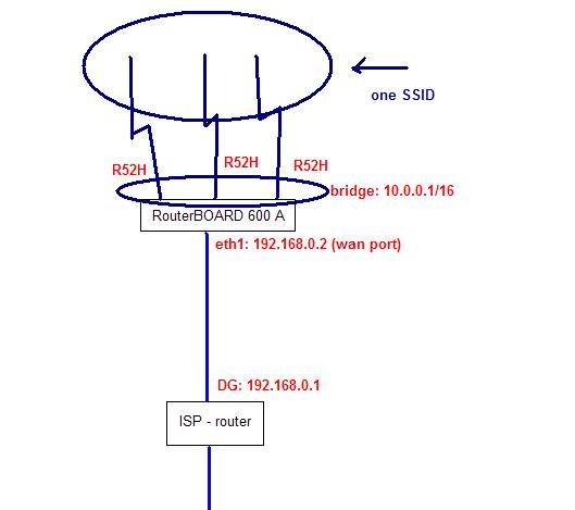

Hi, I need transparent wireless with one SSID. I have 3 R52H card, so I need to configure that all 3 cards are in one network, something like bridge. That is for HotSpot which has one DHCP server.
For now, I configured one bridge with IP addres 10.0.0.1/16, and one hostpot server with DHCP. ETH1 is WAN port with IP 192.168.0.2 and default gateway IP 192.168.0.1 (that gateway is IP address of onother ISP router) How can I include my 3 wireless card to work like one wireless network with one SSID. TNX guys

Yes, correct. I have 3 R52H miniPCI cards on RouterBOARD 600A on witch I have installed HotSpot.
Thanks a lot
Network topology
ok, simple enough.
create a bridge,
  • add all wireless card to bridge,
  • create hotspot on bridge
thats it, you are done
